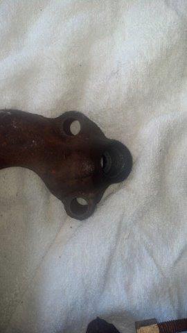

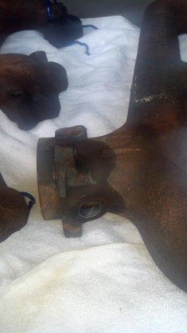

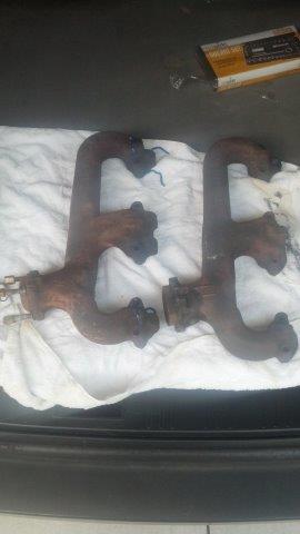

Well, I got my new driver's side exhaust manifold today. Found one from an '88 Burb - has an AIR tap which I'll use for EGR and has Oxygen sensor port in the collector. Only have to weld an Oxy port on the passenger pipe now and do some creative Home Depot tubing (in copper for now) to plumb in the EGR. Pics of LM1 and Burb manifolds attached.

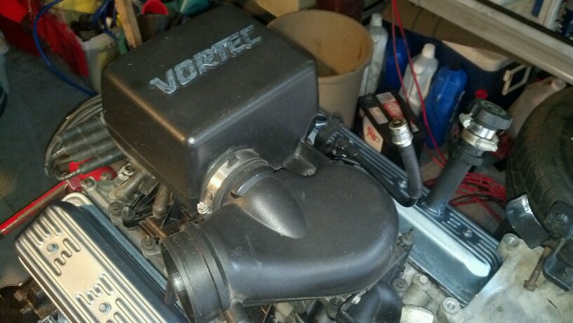

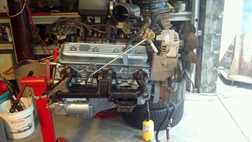

Well, hopefully the new engine is going in this weekend. Got it all pretty - just need to grab an AC compressor and swap the oil pump (no real need AFIAK, but prudent).
Used a spray ceramic for the block and heads and direct-over-rust ACE grill paint for the manifolds and some frame touch up after a thorough pressure washing and soap/water cleaning. Also used that same black on the engine mount brackets and torque rod (rods not there) brackets / engine mount bracket spacers. It came out a little more blue than I had hoped, but historically the 350 in '79 would have been blue anyway (just a too Ford-ish blue for my taste).
Have a '87 TBI fuel sender/pump on the way and new tank fill hoses and a Vortec pump ready to swap in to the assembly. Think I'll just put the tank in teh bed and run soft hose until i get the fuel supply sorted. Also, I think I'm keeping my un-baffled '79 tank and will use a silicone loaf pan with a 1/4" hole punched in the edge as a sump - it will fold small enough to fit through the sending unit flange and if necessary I can drop a couple magnets in it to hold it still. Anyone see a flaw with that plan?
http://www.walmart.com/ip/4244355?w...61770790&wl4=&wl5=pla&wl6=34438921030&veh=sem
After that it should just be wiring. Yay.

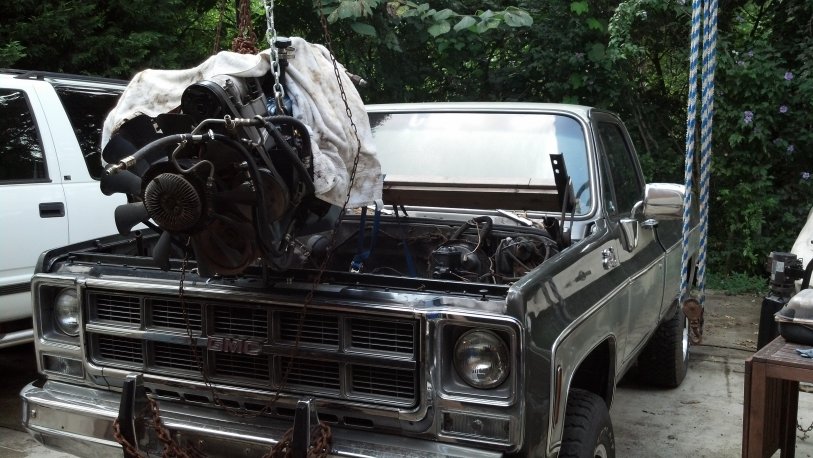

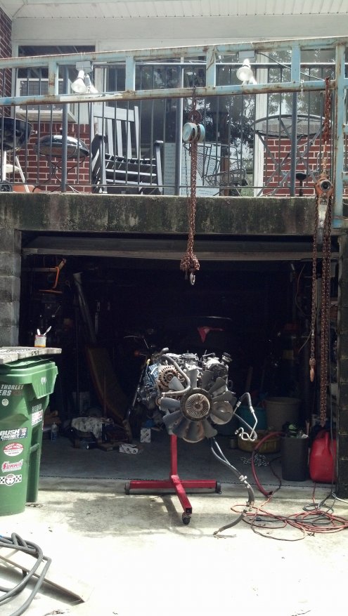

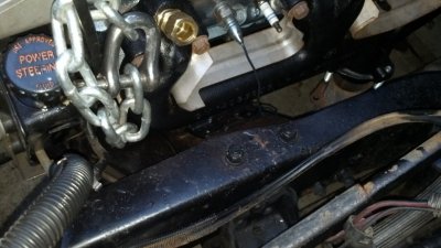

OK, good progress this weekend. Got the new engine dropped in once the oil pump was replaced (cheap insurance), but once it's bolted up to the transmission, the motor mounts don't seem to be behaving. I was able to get one bolt in the passenger side mount at the rubber mount-to-crossmember interface, but on the driver's side, the holes are 3/8-1/2" off (engine needs to come forward). Would it make sense that I need to loosen transmission bracket bolts to shift the whole assembly around? Wouldn't that move the tailshaft around unacceptably? The distributor seems awful close to the firewall too. See pics and please give advice.
The trans mount is the last thing to bolt down.
Try the mounts off the other engine if you have not already, they will bolt right up to that L31 block. The GMT400 mounts wont work. Dont worry about the torque rods...some had them, some didnt. My 86k truck doesn't, my buddies 91 kBurb does. Funny thing about his motor mounts. He has to order 85 mounts. If he tries to order 91 mounts, they dont have options for R/V, so he ends up getting GMT400 mounts and has the same issue as you are having.
The 73 mounts should work just fine.
So I'm guessing by that comment that I should have loosened the trans mount bolts when i pulled the LM1? I didn't, so they're right where they were as long as I've had the truck. No worries on tailshaft alignment? I think I'll start here.
Don't worry about the torque rods...some had them, some didn't. My 86k truck doesn't, my buddies 91 kBurb does.
Should I have left off the torque rod brackets? If for some reason I wanted to run those rods are they available anywhere and what do they bolt to on the other end? I haven't had any success even looking them up.
Try the mounts off the other engine if you have not already, they will bolt right up to that L31 block. The 73 mounts should work just fine.
Do you mean the motor mount brackets (steel cup-type things) or the steel-wrapped rubber mounts? I'm using the '79 rubber mounts and it's apparent that they have the right bolt pattern, just the whole rig needs to translate. I'll be pissed if GM changed an age-old mount bracket by 3/8" from the square to the GMT400.
Mounting bolts at the trans should be loose at least while lining up the engine. I think IIRC, the torque rods just went back and bolted to the bell housing...they look useless to me, but then again, I'm not an engineer.
Take the motor mounts and brackets from the LM1, and bolt everything to the L31. GMT 400 is a complete re design from Squares, wider frame, etc.

Loosened the trans mounts and hooked the engine to the hoist again. Was able to pull enough to get one bolt in the drivers side and all three in the passenger's. That will do for now until i get the rest of it buttoned up to at least me mobile under it's own power. I'm losing grace with my friend's backyard and need to be able to move it on and off the street.

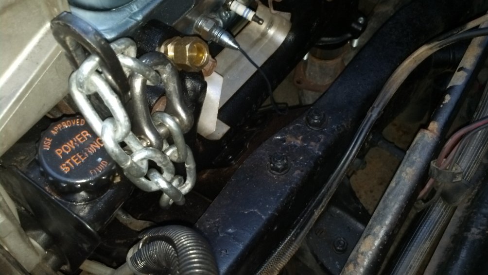

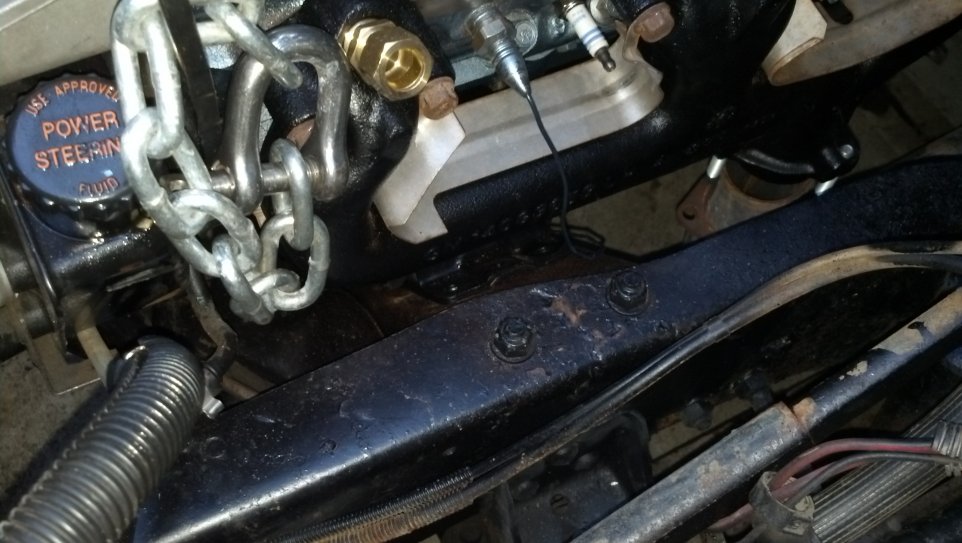

I might have found the unobtainable steering line:
http://shop.advanceautoparts.com/we...t_18070589-p?searchTerm=inverted+flare+o-ring
Anybody know if this is what would connect the pressure fitting of the square's steering box to the o-ring pressure outlet of the '97 L31 steering pump?
Or, does anyone know specifically what the two ends I'd be looking for are? I know the return line is a 3/8 inverted flare and I can make it up out of brake line and hose clamp it to the original soft line.
Some NAPA stores do custom lines...just go that route, and be done with it.

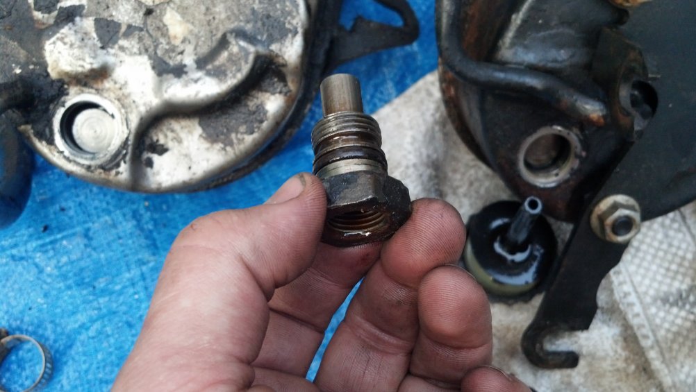

Happy to do so, but I need a hose that goes from what to what? Admittedly, I'm not someone who can look at hydraulic fittings and call out the size and thread pitch.
foamypirate
3,302
467
Central TX
Jake (Mr. Wilson)
El Camino, baby!
5.3L/4L60E

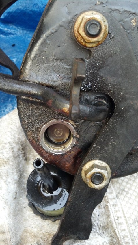

You should just be able to swap the entire female fitting out of your current pump and into the 97's pump. Most people do the LS swap PS this way, you just unscrew the fitting and put it into the new pump. Did the same on my brother's serpentine swap on his 1970'. This would allow you to use year appropriate power steering hoses.

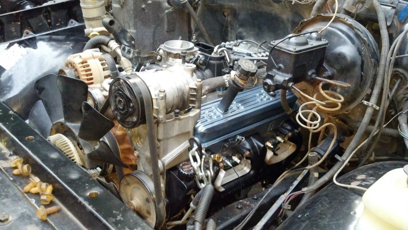

My pump had the pressure? sending unit on it also, so i just took the whole accessory bracket out of the truck and did the swap on a bench. In case anyone has found this thread looking for similar help the pressure unit has a pair of circlips holding the plastic stuff together and then a big brass fitting (1-4"?) holding the cast iron / steel fitting on that takes flow off the back of the pump and gives you an o-ring fitting facing forward. With the circlips off and plastic sensor removed just back out the giant brass fitting and the ferrous fitting comes with it (just sandwiched). Then spin in the inverted flare fitting from the old PS pump and use your old (or replacement for the square) hoses. 5/8 hex on the back of the pump, 11/16 on the pressure line to the steering box, 5/8 on the return from the steering pump.
Yay! One less system half old and half new with nothing inbetween.

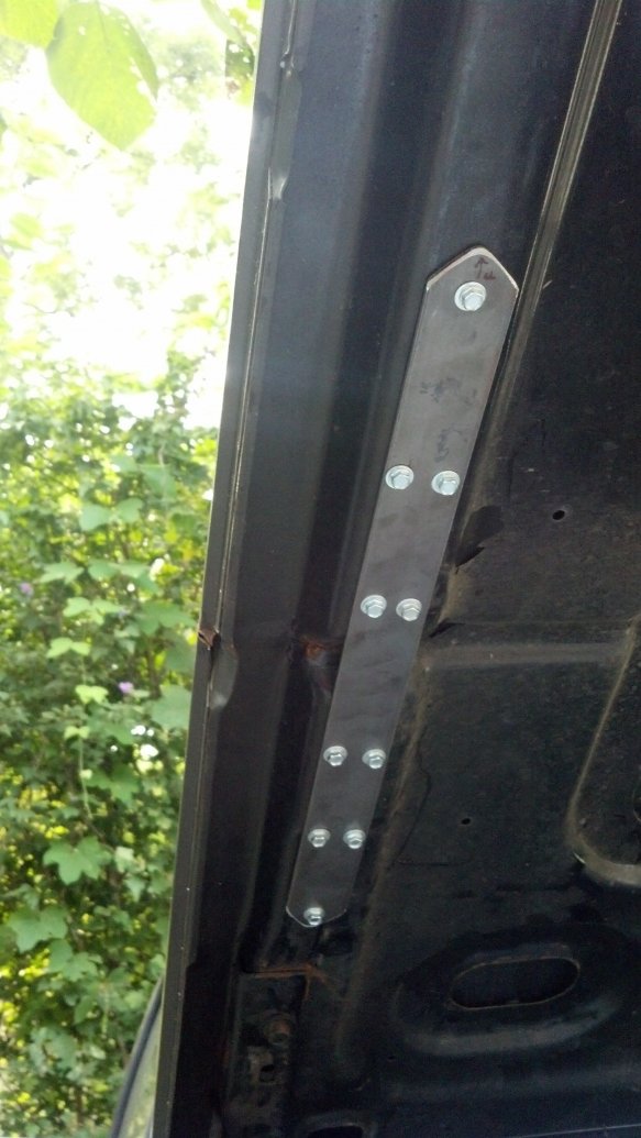

Oh, and i sort of straightened out my hood with homemade straps. Didn't even check LMC - these cost $7
Still it sits high near the cowl on the passenger's side. A spring issue? hinges worn out? I can mash it down but it doesn't really stay.
