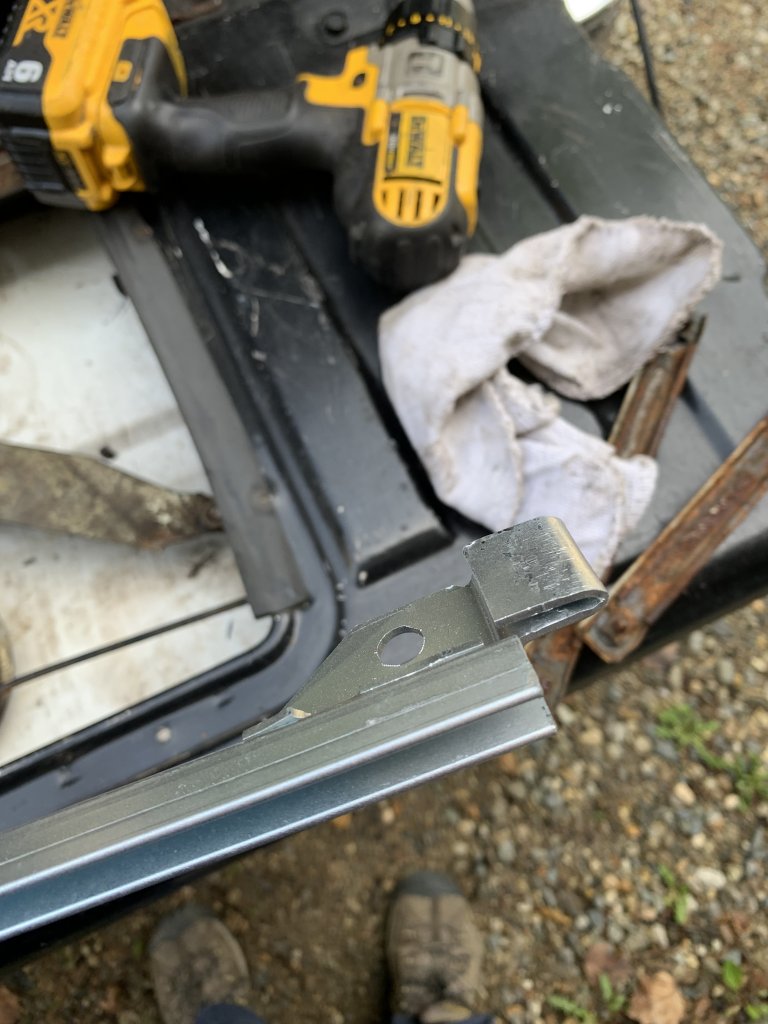

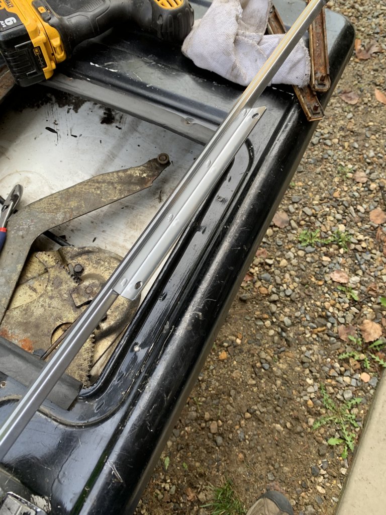

Hey guys my rear window sash was completely gone so i have a new one in hand but not sure which way its oriented. There are two angles on it and some u cannel type things on the end. Which way does it go?

In your second picture, flip it over. That little L bracket with the holes should be facing up with the tailgate down, or towards the interior with the tailgate closed.

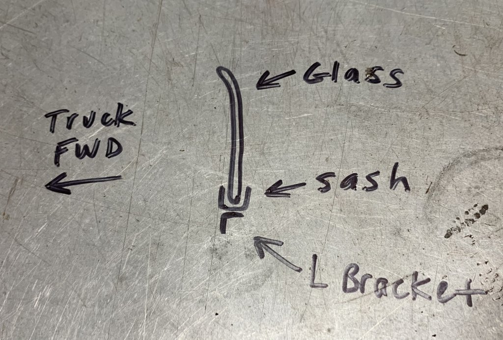

Like this?
