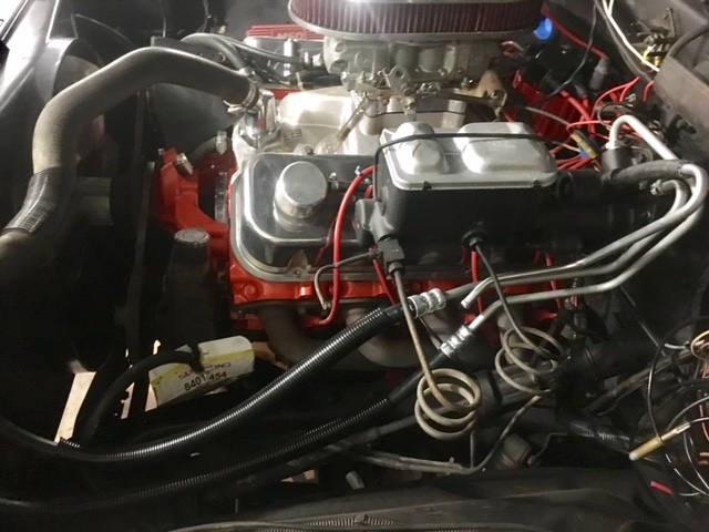

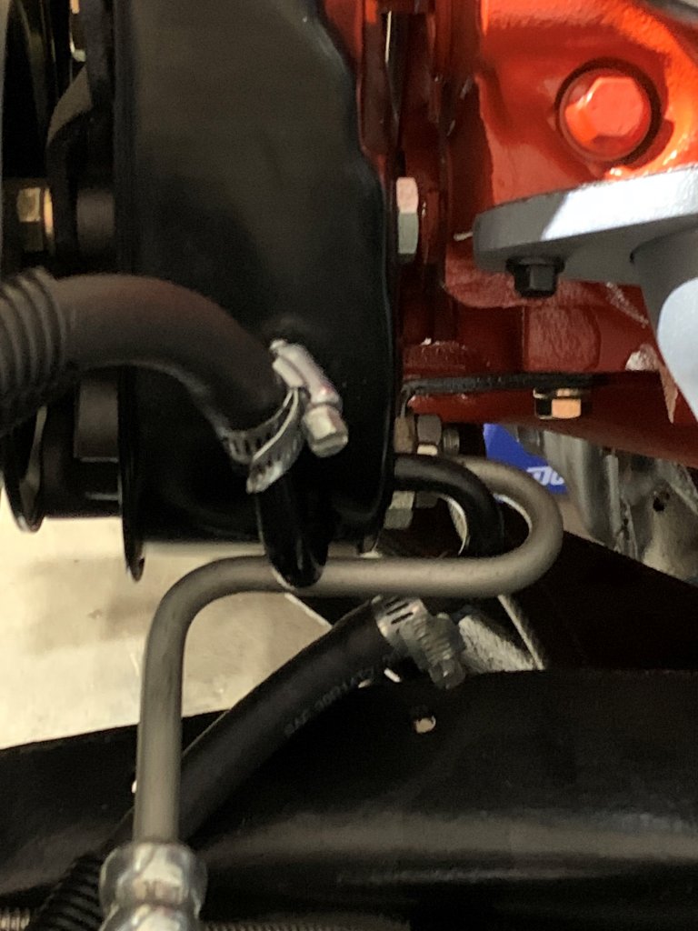

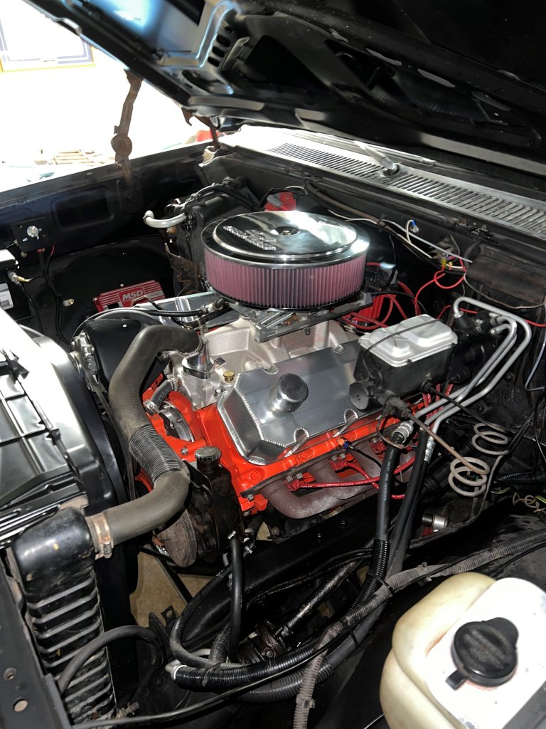

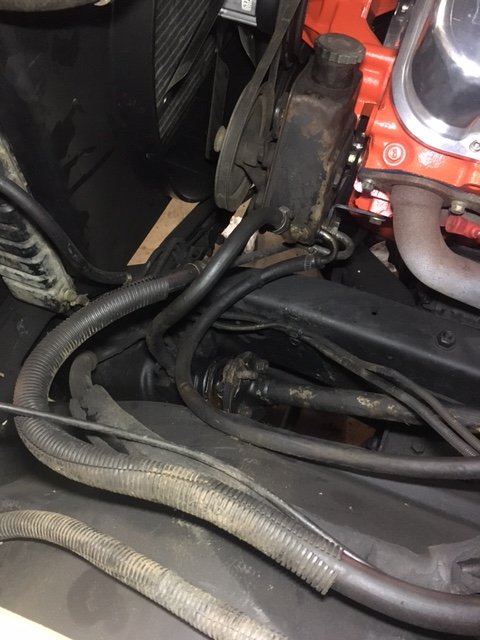

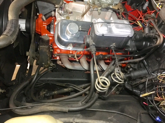

That routing is correct. Not sure if you're looking on a phone or computer, but I took pictures of mine before and after i replaced them for reference. I cant seem to find the close up pictures of the connections on my computer but these should help you out. Never did get an answer myself out of curiosity if it matters which goes where but I put them back the way they were and then followed the bleed procedure after replacing them all.
