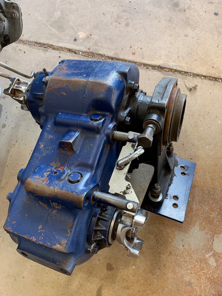

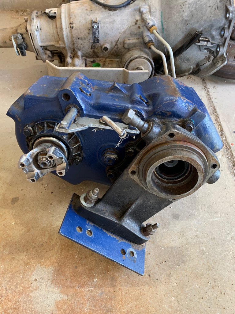

Here is a good place to start. I too am using a 4L60e to NP205 in a 78 Scottsdale 4x4. I researched the hell out of this. here is where I started: https://www.advanceadapters.com/adapter-4l80-to-np205
in doing this you have to figure out the spline type on the bolt pattern of the 205. I have a 27 spline with the 8 bolt config.
I have also seen adaptors here:
this may not be exact to what you need for your 205 but it should get ya started. Also, figure out if you want to twin stick that 205:
its easy enough to do and makes that 205 really work and its really cool too :)
