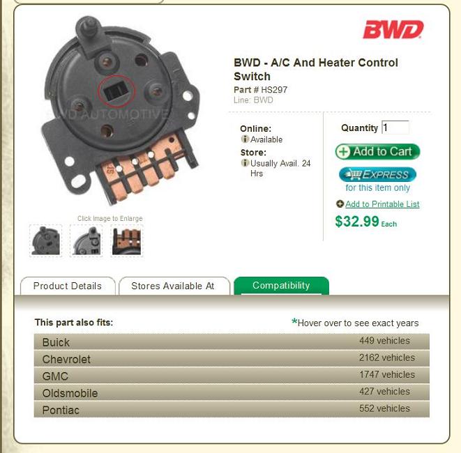

The functional part of the control head is a very common item and may be available locally too. The vacuum ports are on the opposite side of the picture and I circled the cavity where the ends of the clip are that are prone to breaking (as yours did).

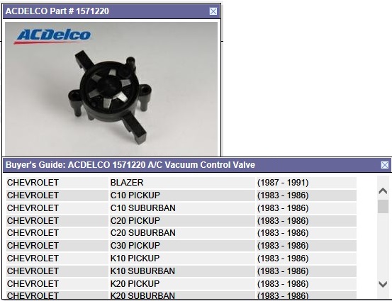

I showed the wrong part earlier, that was the electrical part of the control head. Here is the vacuum part. Same little fastener on both that can break.
Sorry for the confusion. It's terrible getting old...

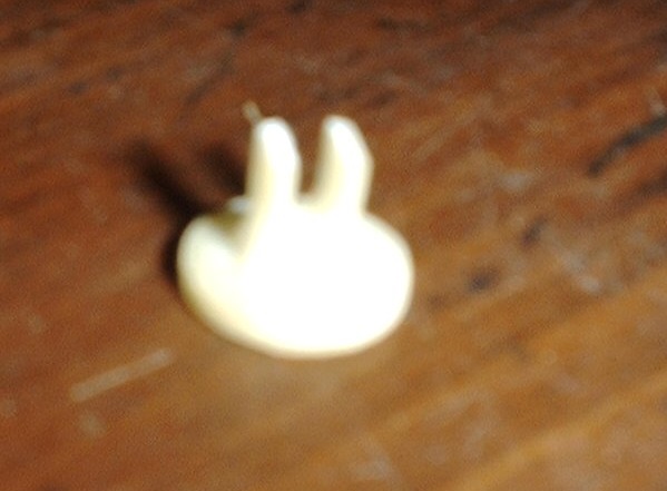

I'll start by saying I've never purchased any of the control head parts, just taken them apart and fixed them. With that said, the broken clip in your original picture would come with new parts, as they are assembled and not meant to be serviced. If we are talking the little metal clips that hold the controls to the control head, I'm not sure. I think the little things may be called Tinnerman Nuts. I think these are only on the plastic studs that hold down the vacuum controller, not the electrical.
