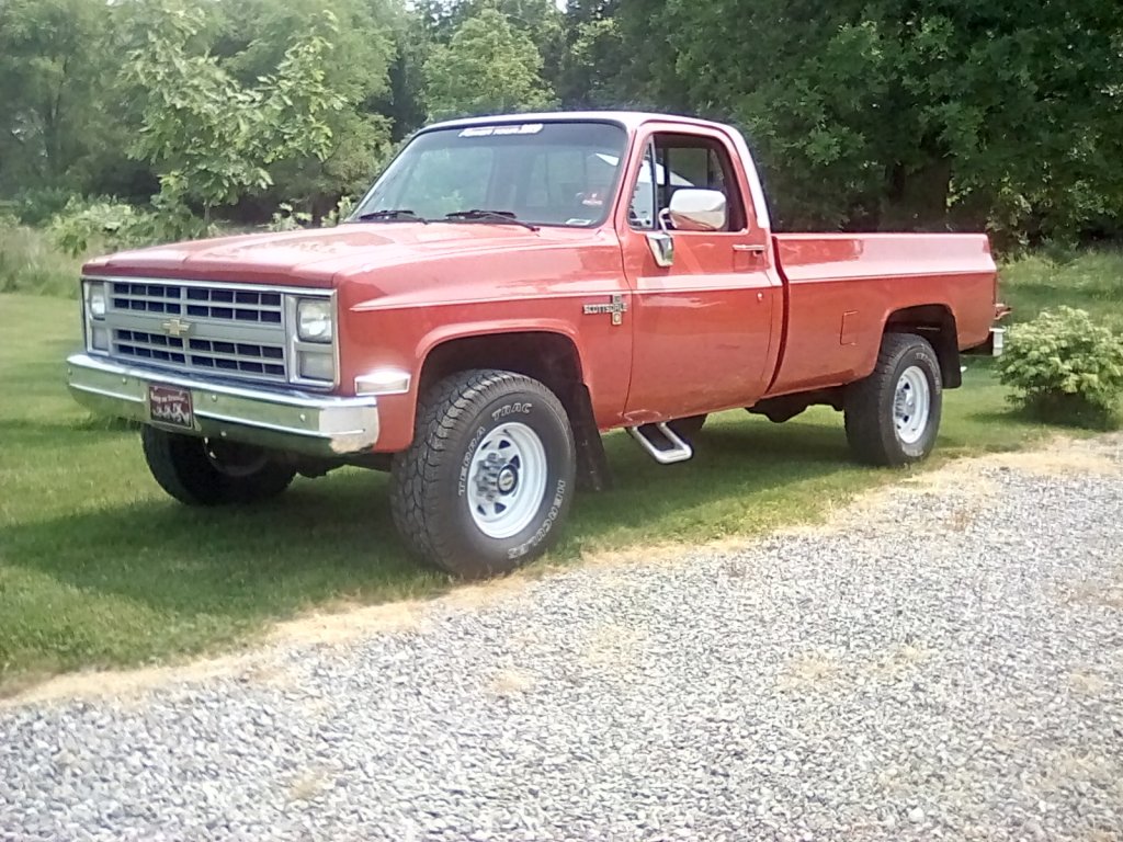

86
496
I’ve been poking at it just seeing if I can non destructively do it. Looks like I will be running a 78-80 style bumper.
The 73-80 bumpers look way better anyway!!! JMO. I have 73-80 style on my 86. But my frame is 79.
