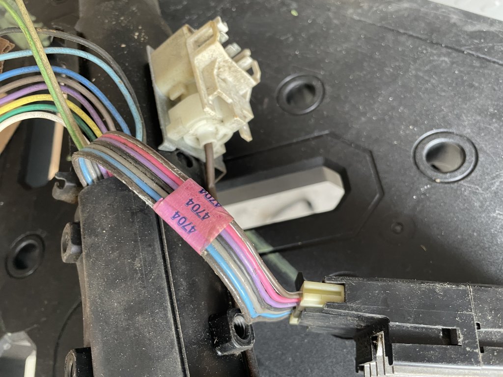

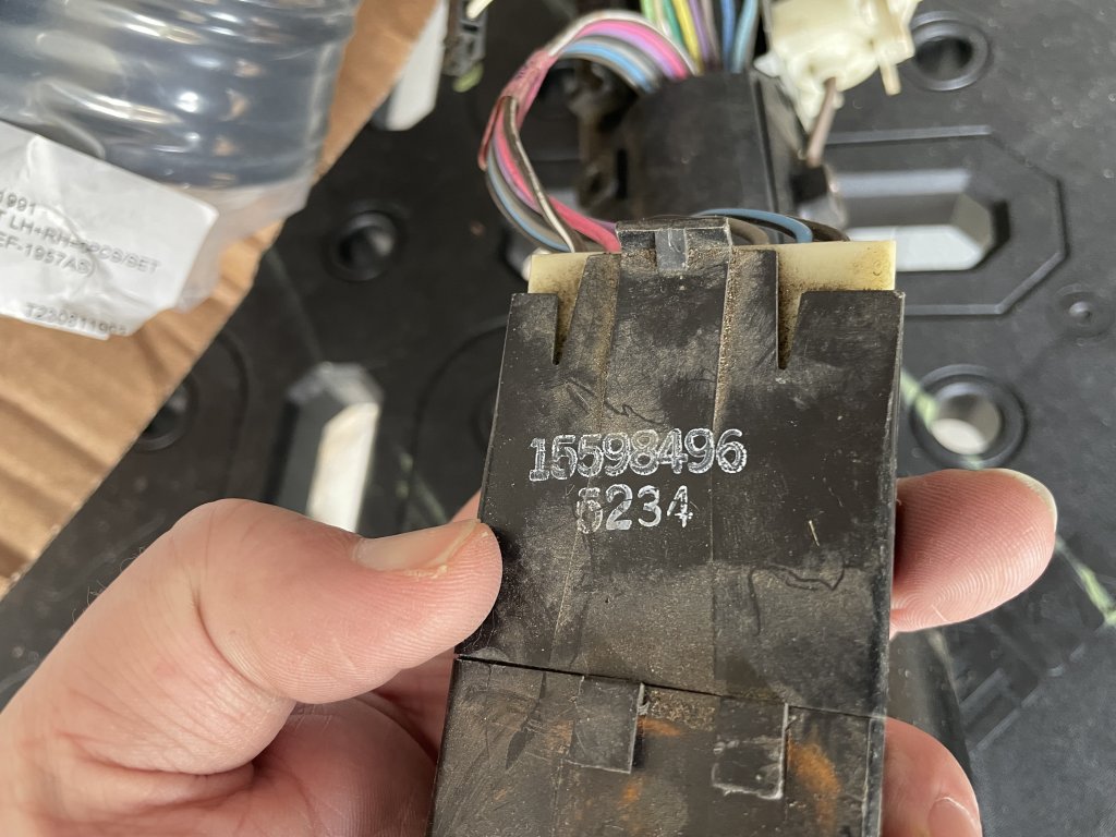

I am rebuilding a non tilt steering wheel that has the intermittent wipers and I can’t seem to find the internal switch. I see a “tilt” version available online but wasn’t sure if they were interchangeable
Any thoughts

81,85
Rock auto DS 812 and NAPA WS 6042
both about $200
There is an extensive interchange fitting everything from a Citation to a G van.
Any pick and pulls in your area?

Any reason this particular part is so expensive ? Seems strange

Supply and demand, just a guess. Unless you know the existing part is bad I would reuse it. Parts today are mostly offshore and poor quality. GM used is better than China new. Rock auto has it for just over $200, NAPA was way more than $300 depending on discount.
