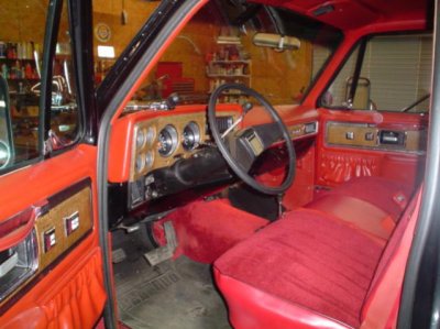

What bucket said,
Good used GM is always best.
Everything can be repainted.
If your lens don't work out, the re-pop lenses are pretty good.
This is how my 77 turned out after re painting.
The Red is called "Firethorn" red for 77
It appears orange in the picture but it's red.
A good automotive paint supplier can mix it.
Good Luck
