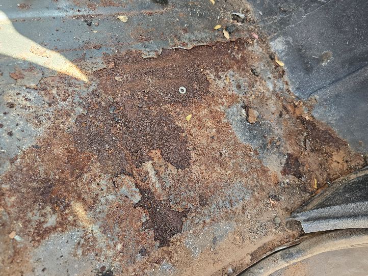

Starting on interior. Today I pulled the bench seat the floor matting and padding. Found a few ventilation holes in the floor pan. Looks like I am going to be learning how to weld

Pictures or it didn’t happen! Also start up a build thread would like to see the floor.

Cut out some of the rot today on the driver side. I have floor pans here, the rockers are on order from LMC.
The rocker isn't as bad as I thought it'd be, just a small spot on the outside I cut out. The interior of the rocker doesn't ok great but I'll get a better look once the floor pan is out. Will be doing body mounts too, before the new floor pans go in.
I dont have a compressor and air chisel so I'll have to drill out all the spot welds. After that I just need to learn how to weld

It doesn't look like the new pans will reach up that curve of the seat hump so I'll have to figure out what to do there
Also, those little spot welds across the bottom of the door threshold are weird looking. It doesn't look factory to me but I've never gone this far into one of these things so I'm not sure
