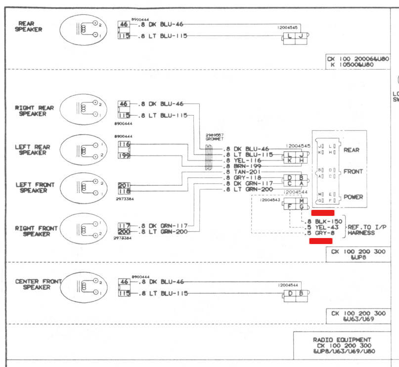

can anyone help with these connections in the cluster area, the black 1 wire connector is for blower fan power i think, the other larger 2 wire connector, black and white wires I dont recall where it goes, nor can i find it. And I have a yellow wire that just has a but splice on the end. single yellow wire goes to?

thanks. i was upside down looking at steering column connections.... I have the original radio on a shelf I will compare.
