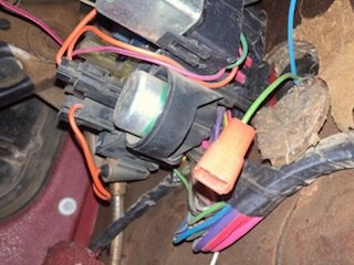

Can someone identify this wire and connector and inform me where it’s supposed to be connected??? I think it’s for the lock up torque converter but not real sure.

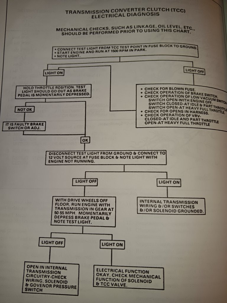

I am almost 100% you are correct- that seems like the test point I used.

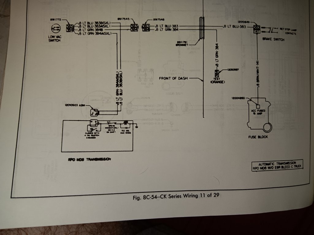

And, see below from an 82 Factory Service Manual.

Not sure about your question, but, with a test light you can follow this test procedure.
