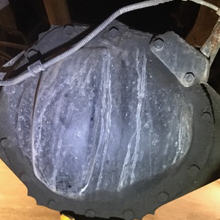

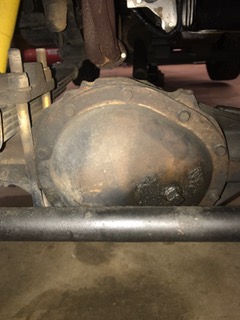

I think the rear is a corporate 9.5 14 bolt. I am still undecided on the front one. Maybe a GM 8.5 10 Bolt??
I am able to upload pics from my computer but not my Iphone. Anyway, here a are a couple of pics.

Front looks like a 10-bolt. If it has 8-lug hubs (which I am assuming it does), then it would be considered the "corporate 10-bolt" front axle. Rear looks like a 14-bolt semi-float..not the "corporate" 14-bolt. The "corporate" 14-bolt is a full-floating axle.
31,918
32,755
Ya, 10 bolt front and 14 SF rear.
