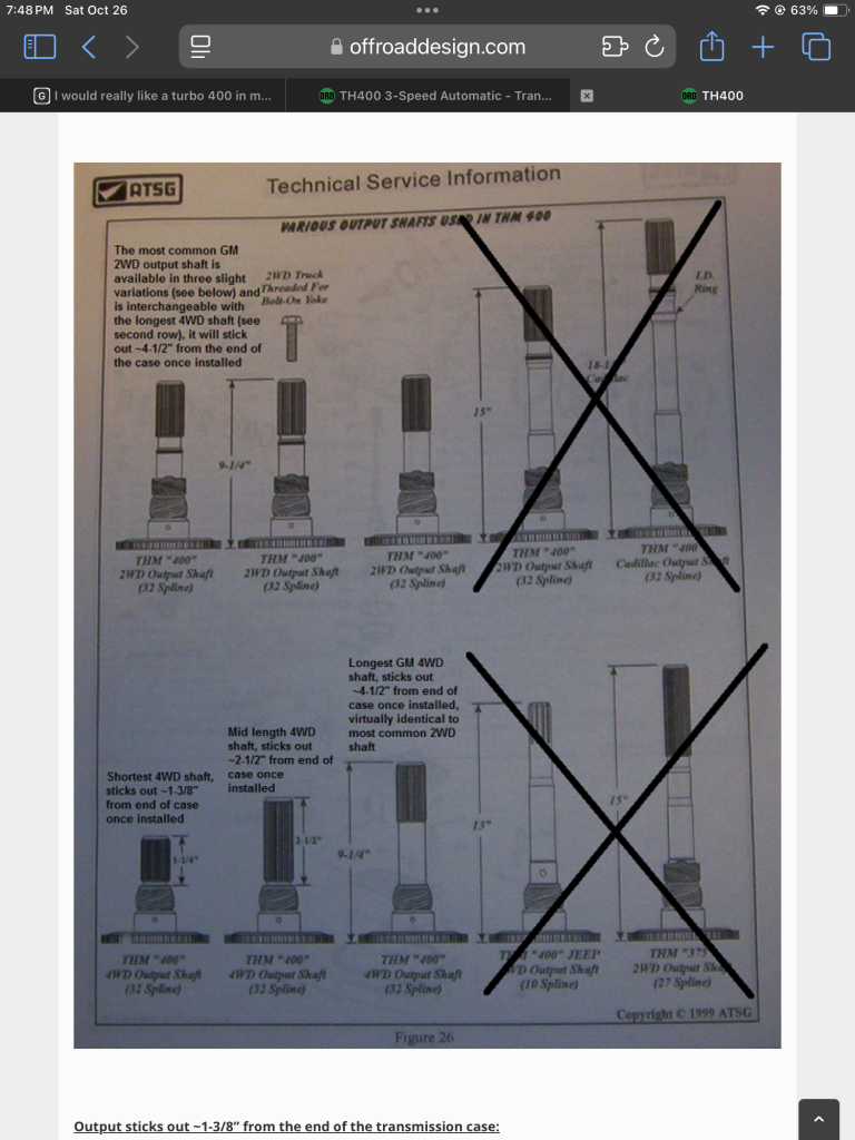

Middle one, bottom row.
The new ones sold by Jeggs & Summit are for drag racing and have no provision for turning the Governor.
Are you sure the 4.5” stick out fits a 208? I thought the stick out was less than a figure 8 205 tailshaft.
