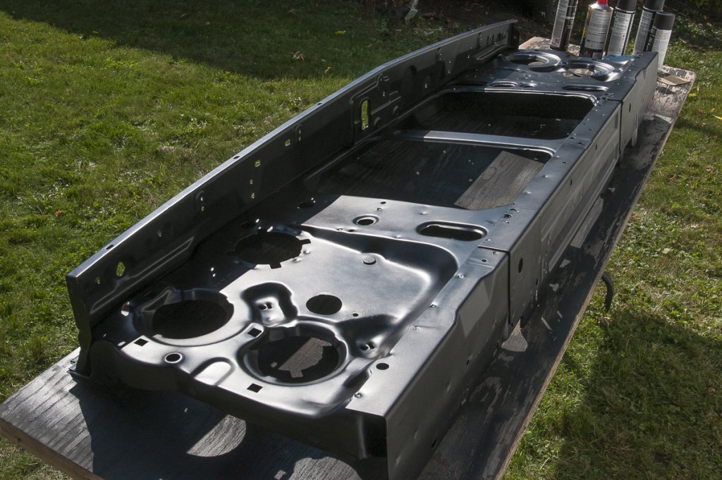

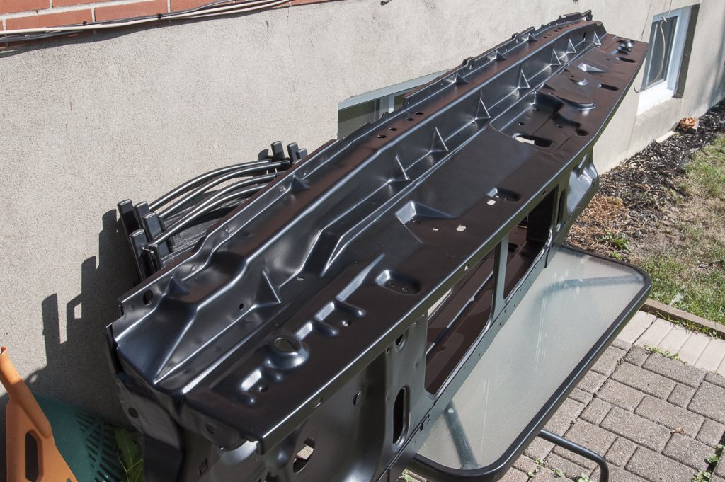

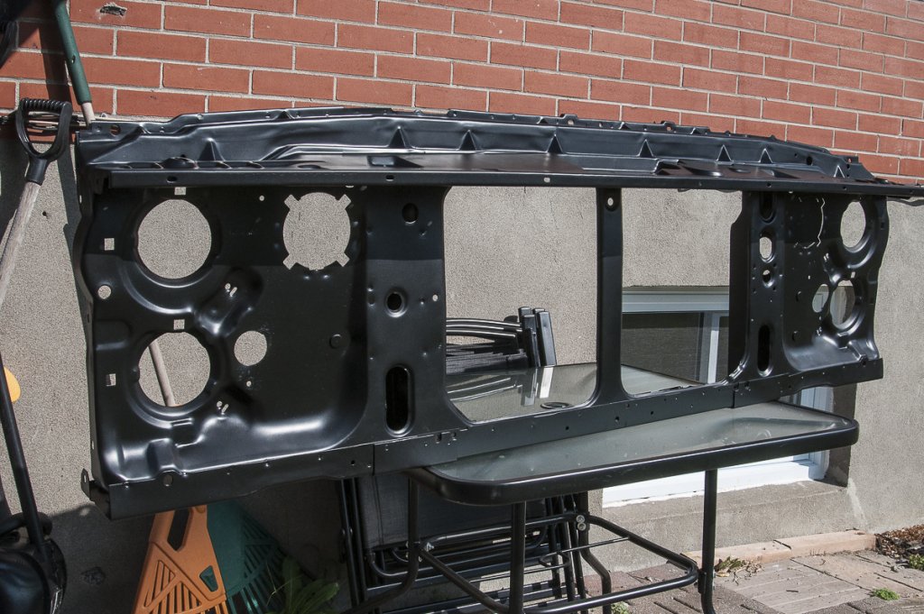

did the same after looking for jobber rad core......... find this OEM at a expensive price but way better dans the other repo! ;)
