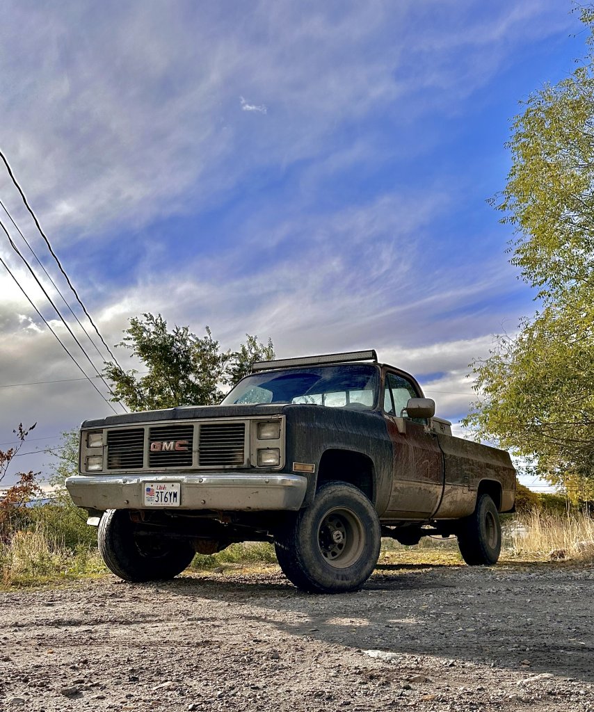

What are the pros and cons to leaving your hubs locked in for winter? I live in utah and it can get pretty bad pretty quick here. Jus wanna know if I’ll damage or ruin anything by leaving them locked in when the bad weather arrives. Thanks in advance
