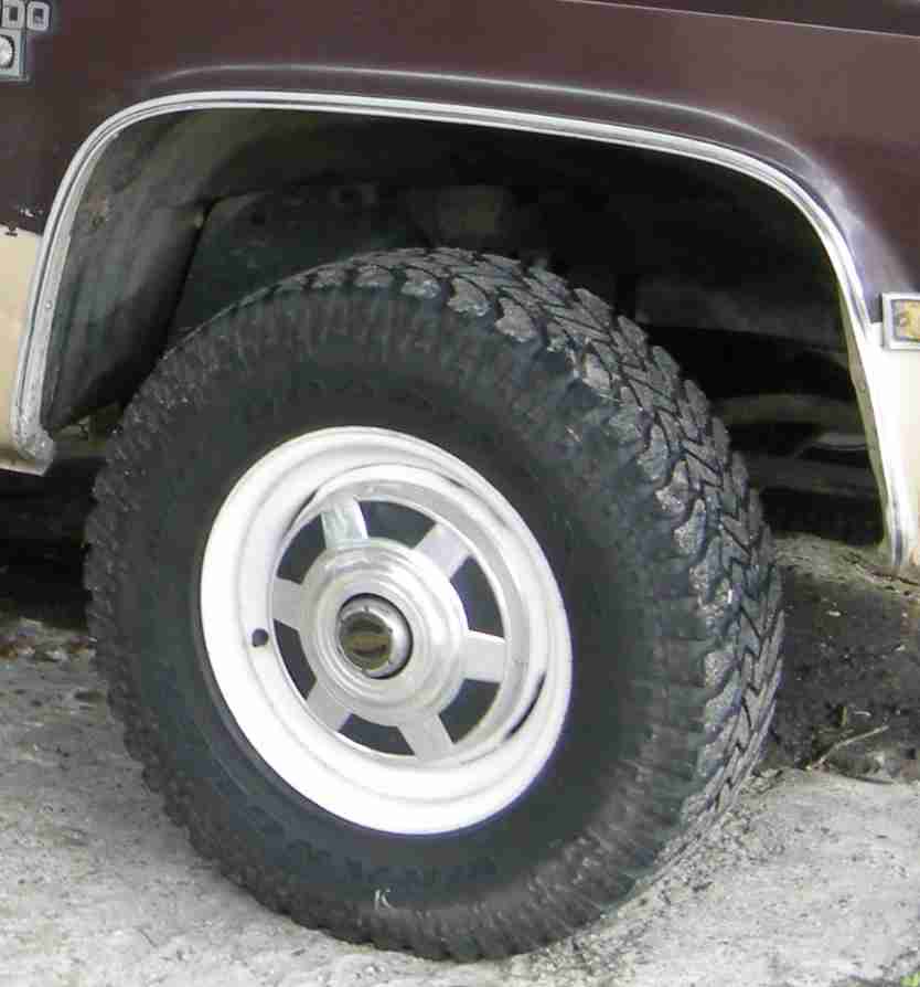

@RetroC10Sport....this (pic below) is on a 3/4 ton 8 lug wheel. Is there a difference where they had the same design but made them different if 1/2 ton or 3/4 ton?
EDIT: nvm...I see that the one I posted are a slightly different design and are probably slightly bigger. Took me posting it close to the other img posted to see the difference :waytogo:

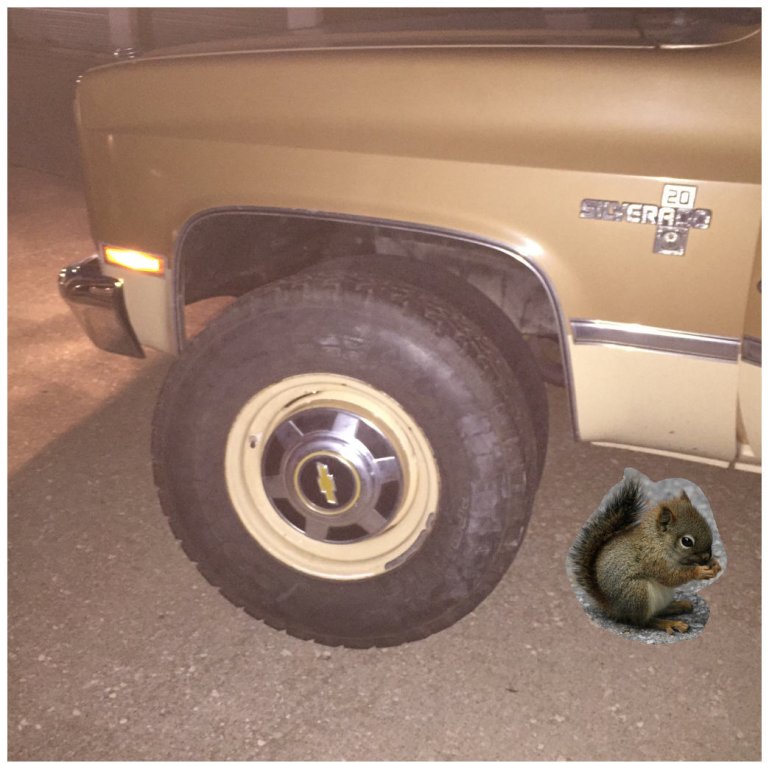

OOPS, I posted in the wrong thread. admin please delete this

^Will not fit a K20, they are for a K10.

NOPE. Re-read your spec sheet. If you have a K20, it prolly came stock w/ 16" wheels/10 plys and dog dishes like this:
Those were not available until 1976. I know the book is saying 1973-78 but it is wrong.
If you will look at your pictures, you are showing two different hubcaps.
