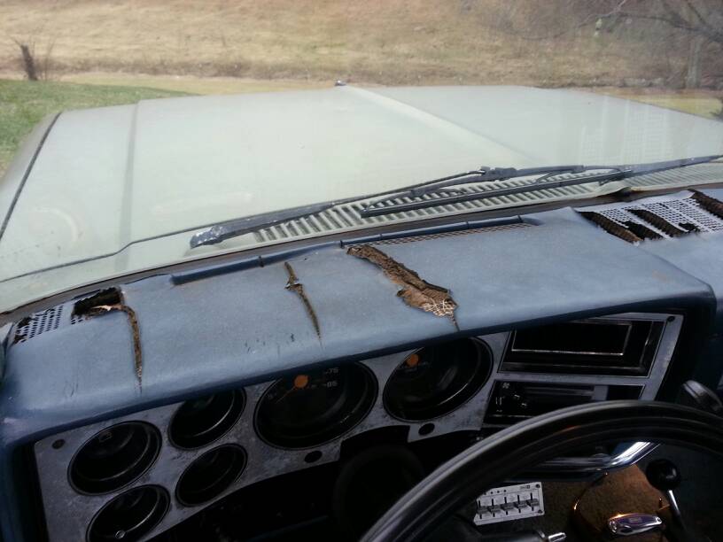

This isn't show quality, but I think it turned out great for a daily driver.
You'll probably be starting off with a dash that looks a lot like this.
First, take a sharp knife and cut off all the curled up edges along the cracks. Cut back far enough to get into the vinyl that's still somewhat soft and not dried out. Also be sure to remove the vinyl around hairline cracks as that area is already toast and will become a bigger crack later and ruin your beautiful dash.
Then cut all the perforated areas out of the 2 outer speaker locations. We'll fix those areas later.

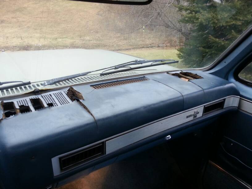

That's a nice dash pad? The steps are the same whether you have 1 crack or 50.
This obviously won't work if half your dash is rotted away or something...

Ehh.....I think you have a pretty good chance of making that one look good. It'd just take a little longer.
That is pretty bad though. :Grenade:
