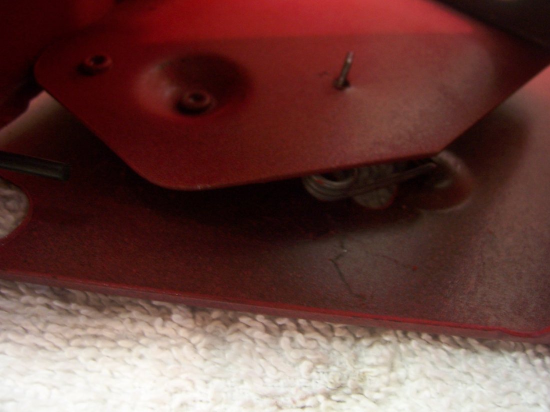

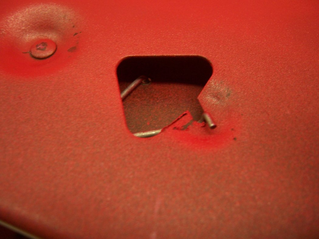

What's the trick on successfully loading the two springs for the tray return?
Was going to respond to this earlier but lost the thread.
I don't recall there being a trick.
A couple pics shown below:
K
K
2 more good pics. I'll add those to the Ashtray Thread.
