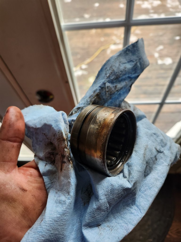

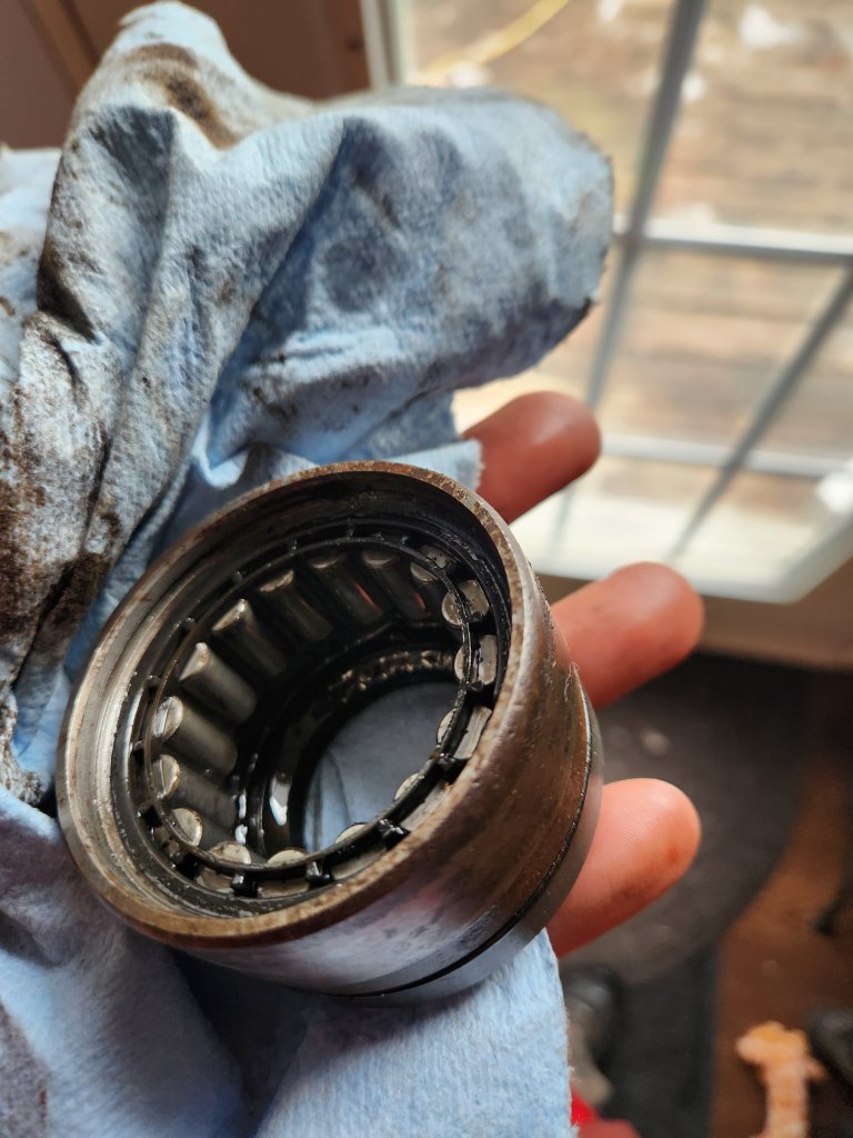

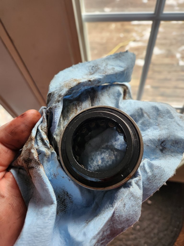

Heat and cold worked a treat. Got the driver side in.
Driver side shaft had normalish wear but passenger side, yeah I can see why there's a repair bearing in there. Geez.

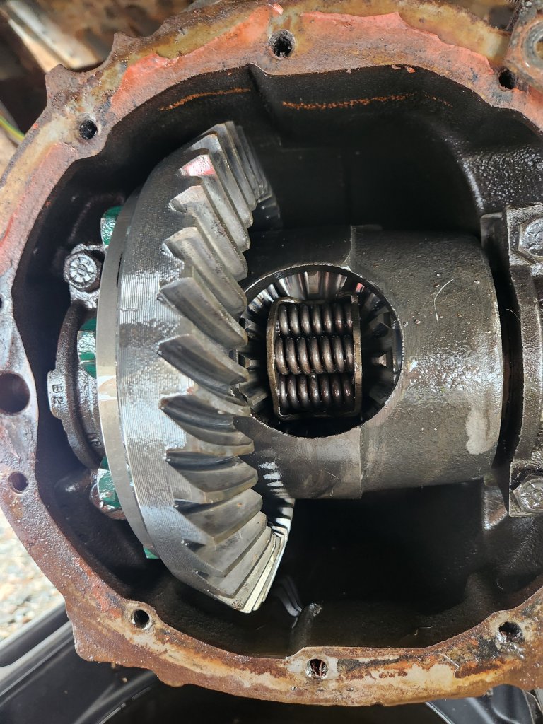

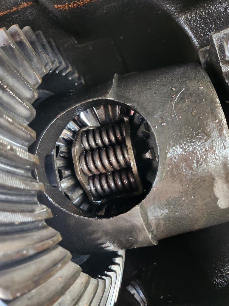

The cross pinion shaft bolt.
That Lil tiny 1/4 bolt thst holds the shaft between the spider gears. Well. She was finger tight. I got a new one. And red flavour loctite
I believe the torque online i 25 or 27 ft lbs.
Do you guys have a different recipe that worked for you in the past.
I don't wanna go too crazy. If that snaps. Oh man....

Great success!
Different is all buttoned up. Lost daylight. So tomorrow will be filling the diff and then brake reassembly. Should be fine from here.
