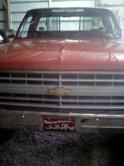

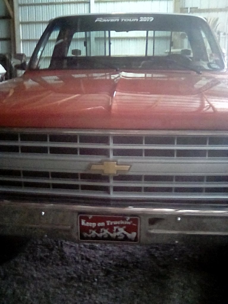

Ok. If anyone can spare some time, I would like to build a parts list of everything I need to order. Probably from LMC...
1st pic below is what my front end looks like now.

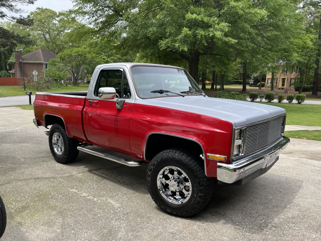

It came like this; I don't like the grille or the Head Lights they used; I want a closer to OEM style. JMHO, I think the Blue trucks Grille looks much better like that.
2nd pic is pretty much what I want it too to look like, Grill/lights wise.

I agree with your grill swap. I have basically the same style and I’m back and forth on OEM. I’m always pondering “when” I’m gonna do it.
I will say tho- I wanted LED headlights BUT HATE what I see UNTIL… I found the OEM LED lights from a fella in Fla. I can dig up the information if you like, I’m telling ya, they look original until you turn em on! Little pricy- but well spent $ in style and performance!

you already have the headlights and adjusters. No need to re-purchase them unless I’m missing something. Your truck just has a phantom grille in place of the OE grille and headlight bezels.
I'll have to look closer at it, the headlights that are in mine are some goofy LED lights where there are like 12 different LEDs in each and some of them are burnt out. And they kind look like the guy that had it before attached them to the back panel (whatever its called) with wood screws or something stupid.
I just want to go back to factory style lights or close...
I looked at the wiring (somewhat) and I know there are tails that come off each light are about 12" long and I guess plug into the factory harness' sockets...
I honestly, don't know what I'm doing and between two jobs + on call, I don't have a ton of time to work on it, so I'll run out there, look at a few things then go to work or do whatever comes up...
I'll look at that though, thanks for the idea, IF I can save 30-60 bucks, thats 30-60 that can go towards other stuff thing POS needs... :)

Ok, ya couldn’t tell that from the pic. Those phantom grilles typically go right over the Oe headlights and OE headlight buckets (the adjustable part).
If you need the hard parts behind the headlights, may start lookin for someone parting out trucks or junkyard. As a more economical option. Those pieces would generally be untouched.

I recommend the correct style 1982 quad headlight bezels.... over those chromed 1985-88 in that photo.
