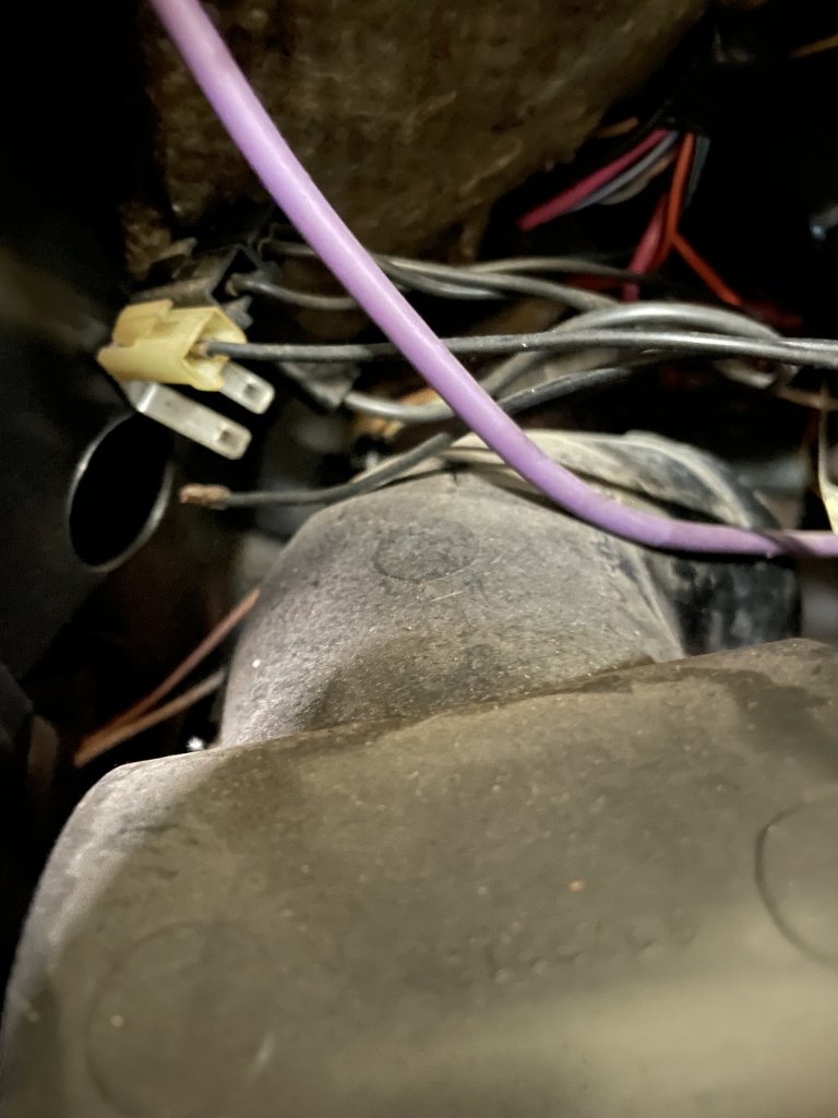

So, I then lost my mind and pulled the whole dash and cluster. My initial thought was that the circuit board on the back of the cluster might be bad.
After pulling the cluster, I found this (photo attached). I assume this is a common ground for multiple items. It looks like I have one loose wire back there and there are a couple spade connectors dangling unhooked in the vicinity as well.
Does anyone know what two items should be connected to these spades, but aren’t? I’m really hopeful this is my issue.

If that is on the left kick panel- that is the main ground location for things inside the cab- definitely will cause problems if things are not grounded well there.

Does anyone know what two items should be connected, to these spades, but aren’t? I’m really hopeful this is my issue.
That's the ground bus and there were a few "vacant" on mine, so you may not be missing anything.
