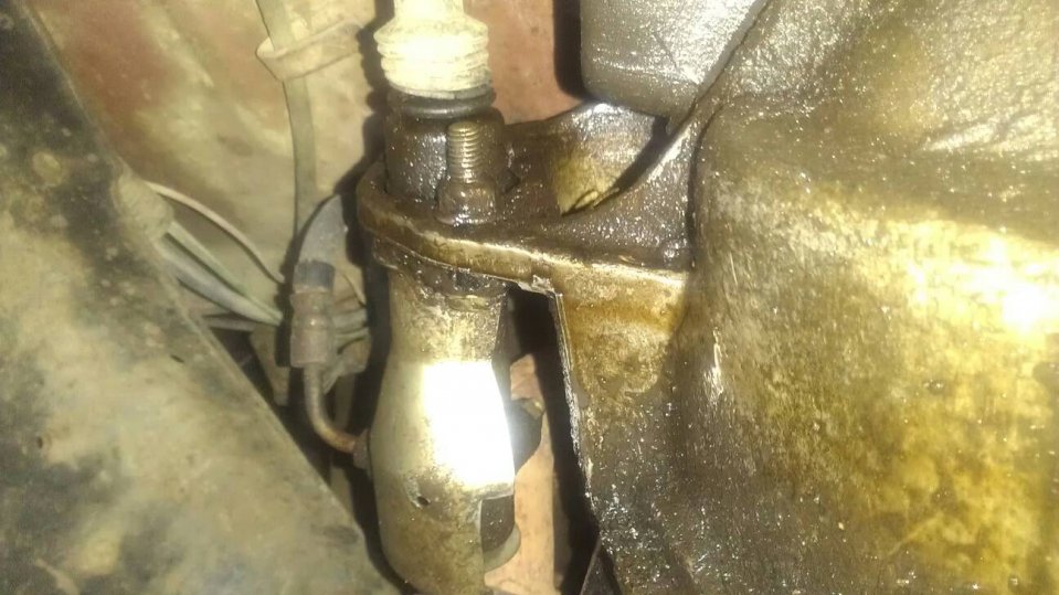

For your clutch, you're going to be more concerned with pan gasket, rear main seal, or clutch slave cylinder. Valve covers could do it, but if your bell housing is tight to the block, that should be a major issue. How about a cover on the clutch and flywheel? Do you have one on it or is it open to all the elements?

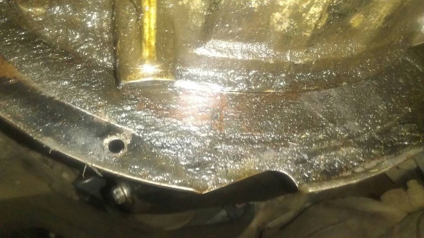

That's good. So you know nothing from underneath is getting splashed up in the clutch area. This also helps in diagnosis. There should be a weep hole in the cover. If there is fluids leaking out of the weep hole, then you have a problem. There should be nothing inside the cover except dry clutch dust from wear.

I finally got under and partially removed the cover. Too lazy to remove the starter so I didn't come all the way off. The inside of the cover and bell housing were oily. The part of the flywheel I could see didn't look too bad. The crappy picture of the cover is the inside part
