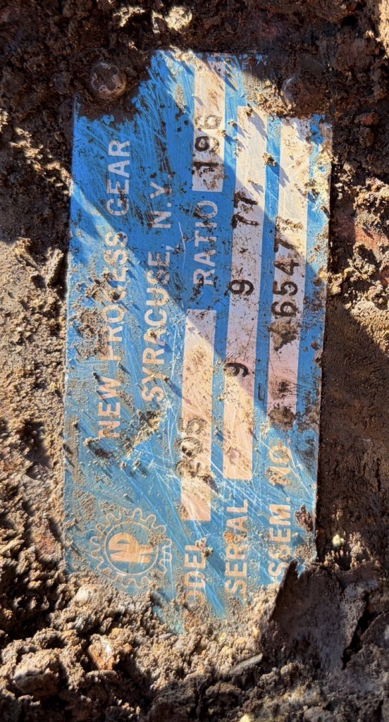

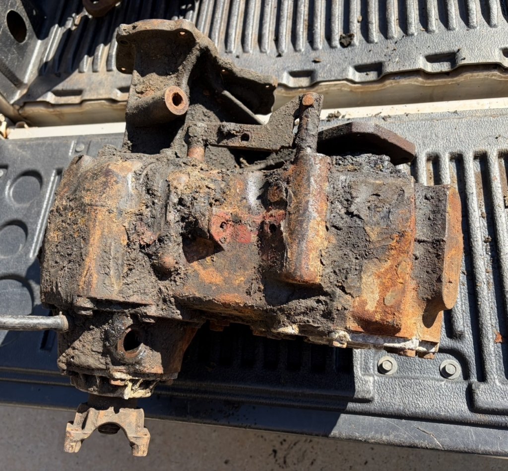

I need some help in identifying this np205. Got it from my cousin who said it was out of a squarebody, but I recently had a guy want to buy it, but said after looking closer, thinks it’s out of because it has a rectangle name plate. Figured I would see what the experts here said. It has 10 spline input and pretty sure it’s passenger side drop. Am I crazy?

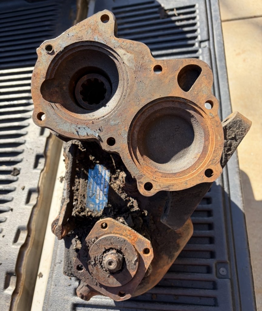

Here is a shot of the tag and input spline adapter

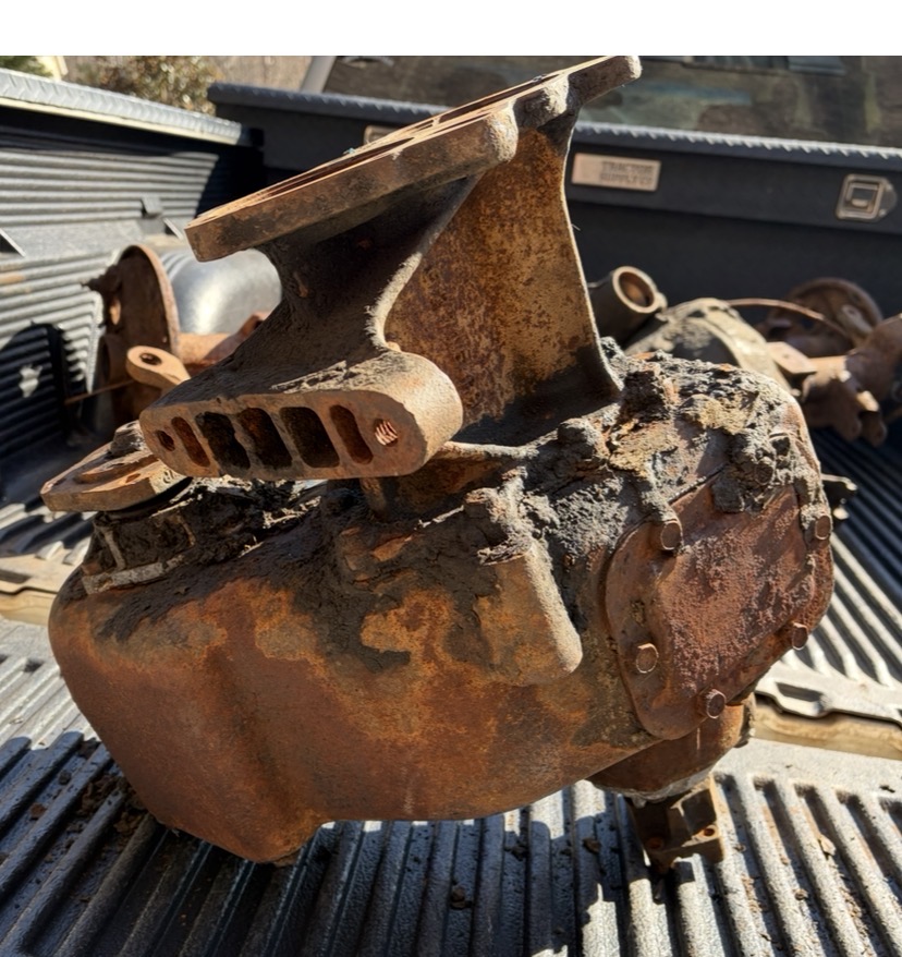

Based on the adapter it’s an 84 or older 10 spline GM unit off of a 4spd.
The tag says 77 on it. I didn’t think I was crazy. Looks like a passenger drop front to me.

Yeah for sure a 70's 4 speed 205.

That front output flange makes it '77+, doesn't it?
I believe that's correct. My k20 was a 76 and still had the non flat yoke. I've got a 73 205 that is the same as the k20. If it was original in any way that is.
Also his tag does say 77.
