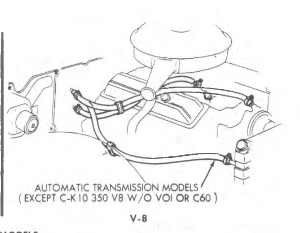

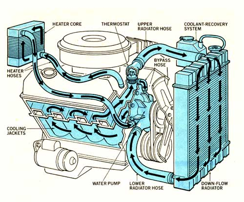

you have the hoses routed the right way ??? just a thought. you either have one hose going to the rad or 2 have the hose going to water pump and one from intake manifold

Not sure Sid if reversing the hoses to the heater core would change much, all else being correct and equal. Simply feeling both heater hoses when everything is up to temp and set to make cab heat should show how much heat drop is going on. One hose should be a little cooler than the other, not a whole bunch.
Thanks for the diagrams on flow, that's great information for the uninitiated.
