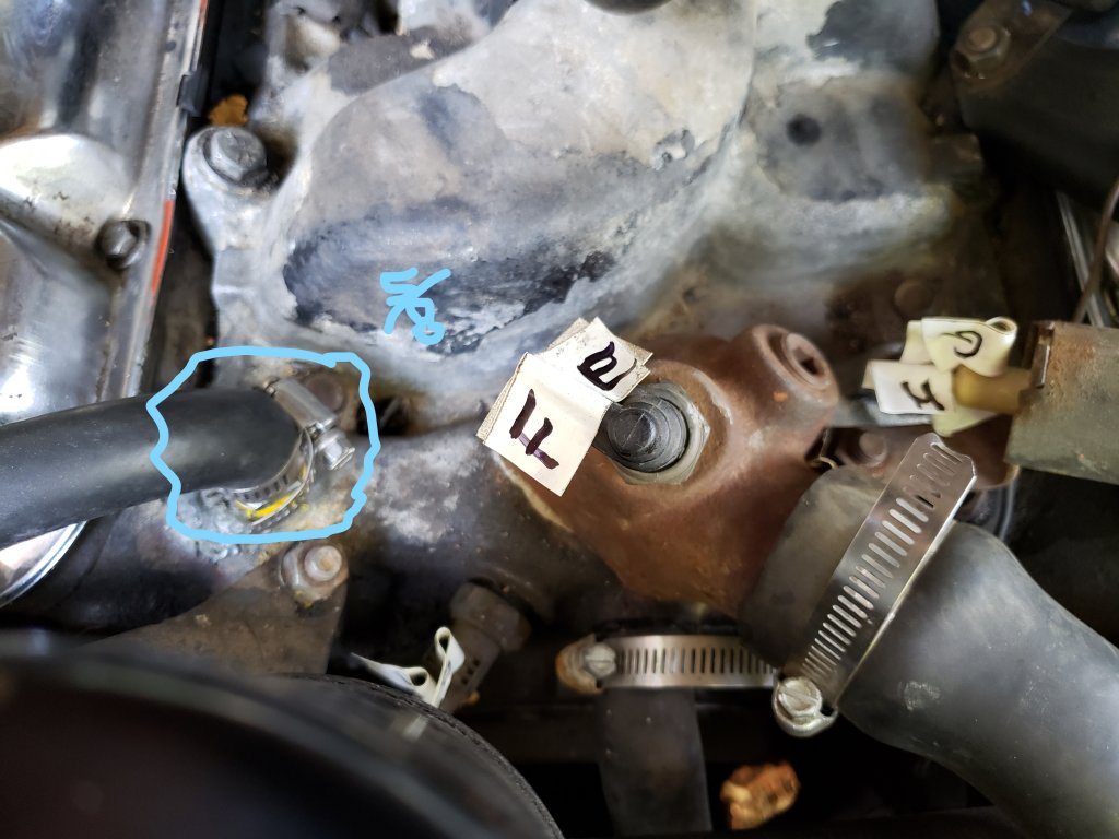

On mine the 5/8 goes to the intake then to the right-side fitting on the heater core. The 3/4 goes to radiator.

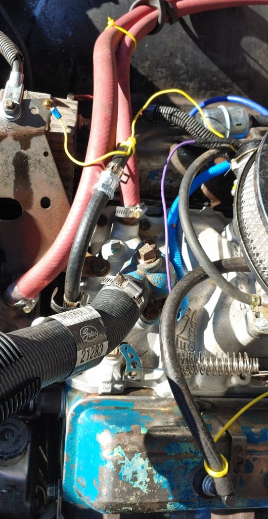

not the same engine or the same year or the same etc etc but my big hose goes to water pump and the small one goes to intake.
my heater core is side to side tho not up and down, but the hose diameter is pretty standard across makes..
