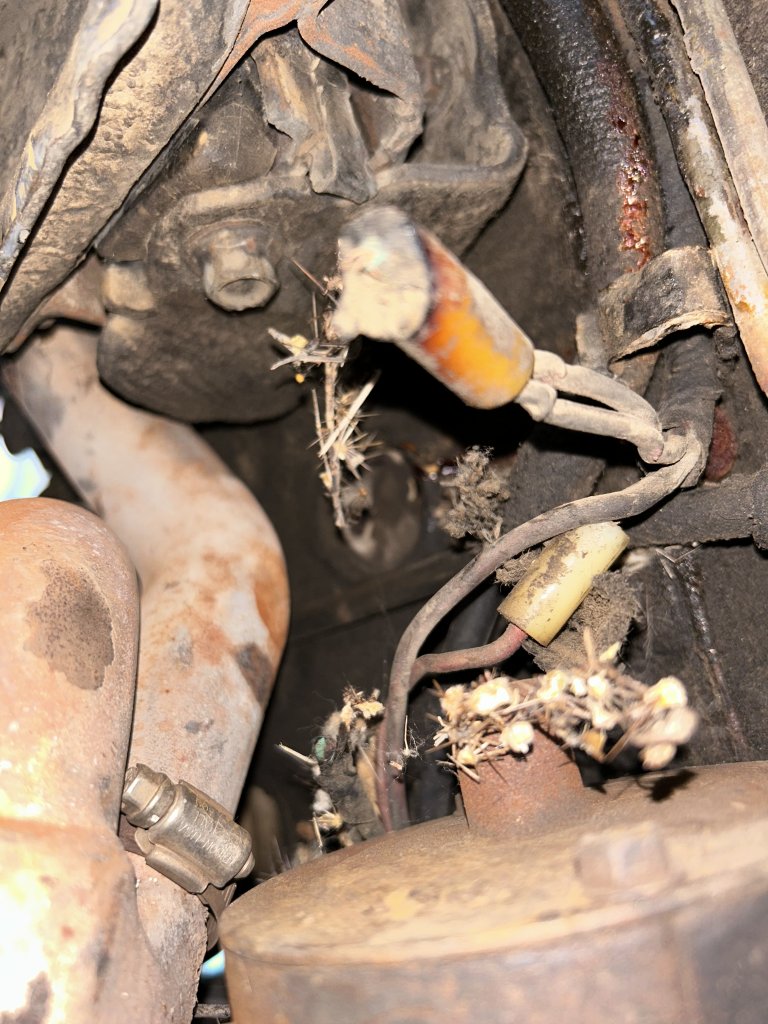

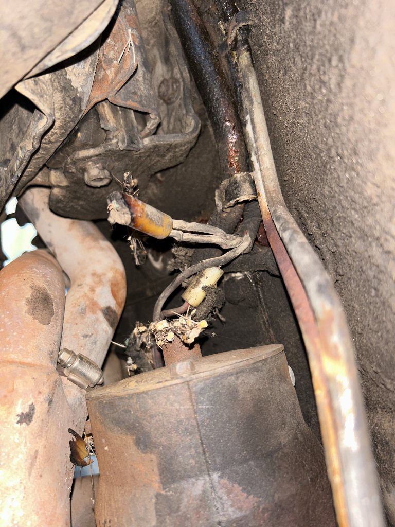

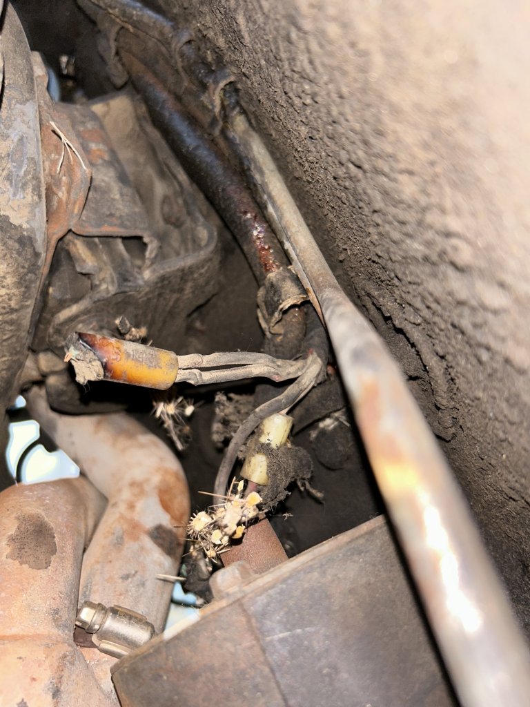

I have a 1983 Chevy c30
No working gauges or headlights tail lights
My alternator also will not charge…
Is it this wire thats fried near the starter??
How do k go about fixing this???

Likely that's a fusible link. Go to a Pull-A-Part and score another. Any GM truck will do. Get the entire wire if possible. It should run to the power distribution post on the firewall.

Thank you brother I Figured it out.
Went to Autozone picked up 2 fusible link wires
Cut and spliced them up accordingly to my starter wires and Boom Got all my Lights back thank you!
