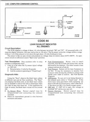

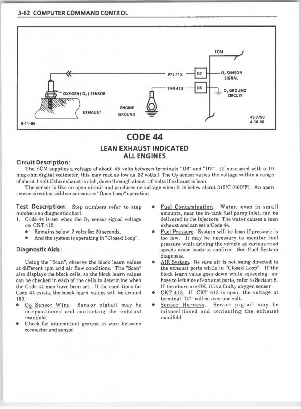

As per Jims86 - check your primary grounding. Not just the ECM ground but the main cables from the battery to the frame/engine and frame to engine.
Check the lead from the ECM to the O2 sensor. Look closely at where it passes near the manifold and exhaust pipe.
Check the primary lead from the battery positive to the starter solenoid - look for bad insulation and shorts to ground.
