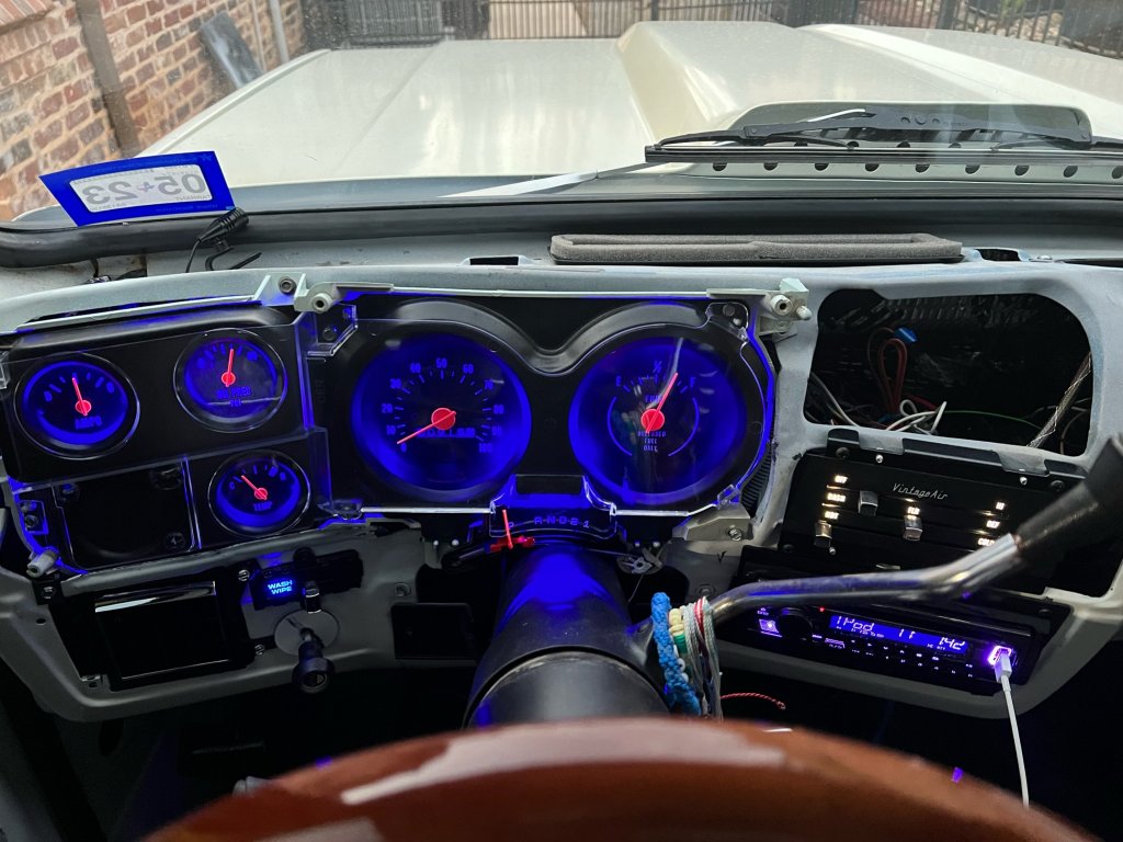

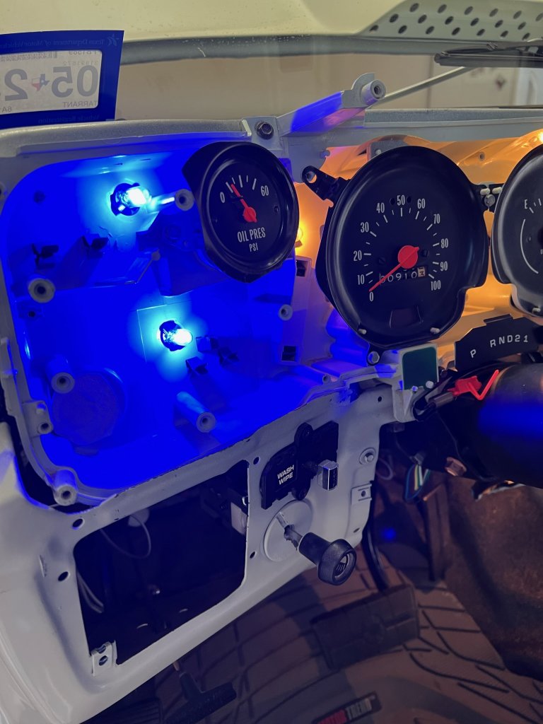

So @Ron Sebastian am I understanding you correctly, just plug in 194 LED bulbs into the cluster for that look and color?
Randy and Easton
It's that easy. I would suggest getting dimm-able bulbs. Did not want to dig into the radio, so that is still white (original). Transfer case bulb is also plug and play like the console.

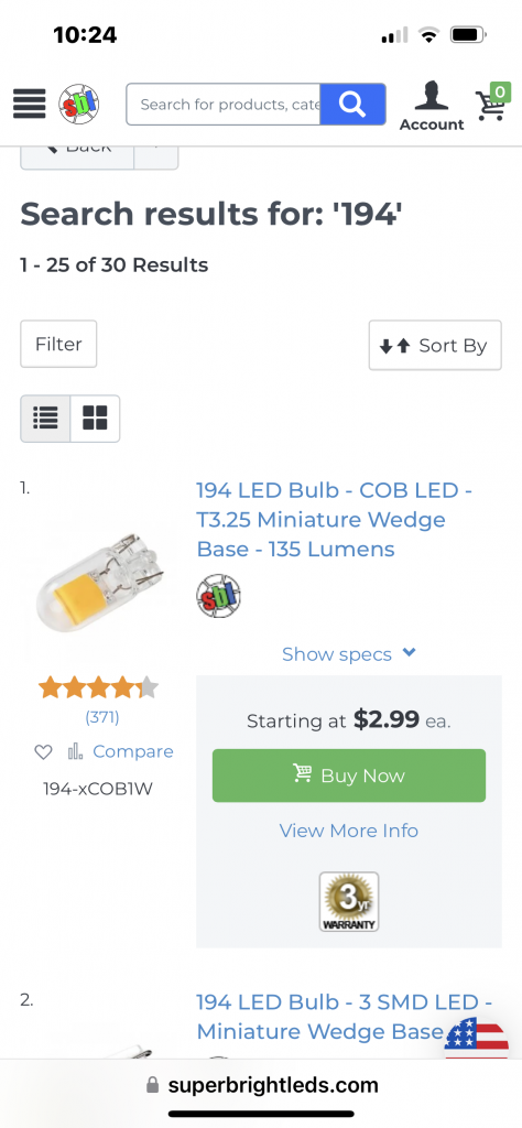

Superbrightled.com has several 194 bulbs listed.
Which specific bulb did you purchase?
Thanks
