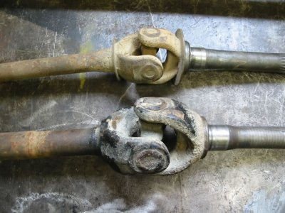

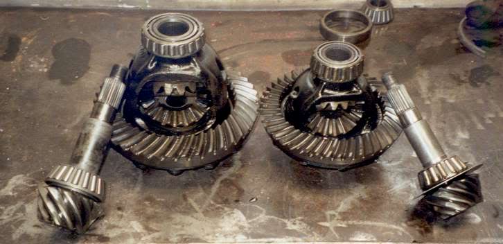

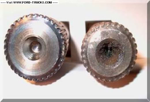

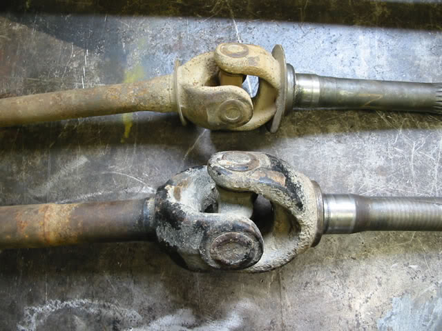

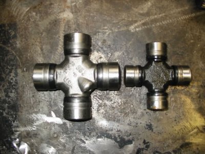

If you plan on wheelin it hard you'll want to upgrade axles as well. Compare these D44 components to D60 (courtesy of here):

As for gearing 4.56 may be perfect if you plan on sticking with 38s. I have 5.13s and they seem a wee bit low with my 38s but I plan on going bigger in the future. You can use this gear ratio calculator to estimate your speeds and rpms depending on your tire size, gear ratio, trans and t-case...
