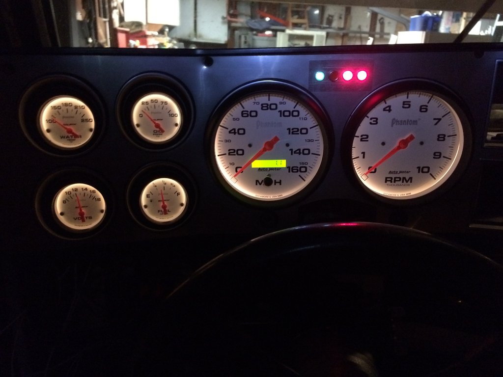

Anyone ever installed 2 5/8's gauges in place of the stock ones? I was going to mount them under the dash but I've seen where put aftermarket in their dash panel. Mine are mechanical and I don't want to screw up a good cluster. Mine has the gauges plus the clock. Also need a 3 spd shift indicator if someone has 1 for sale.

I did mine like this don't know if this is what your looking for

You changed all of them. I've seen some keep the speedo and fuel gauge. Wondered how they done it. Yours look great though.

What brand of gauges are those? They look good.
Speedway Black 6 Gauge Set
but I used a autometer fuel gauge the one that came
in the Speedway kit didn't match my fuel sending unit ohms
there not a bad price and look good

Did you speedo cable hook up?
10,697
11,681
This was in my 82 Longbed

That's a nice looking panel.

Yes that is nice. I really like the white gauges.

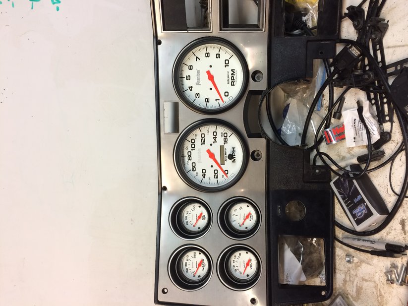

Cant say for 2 5/8 but the 2 1/16 auto meter fit pretty well. You'll have to hack the back of the cluster for these to fit. I love how they sit, can't say the same for the big tach/speedo as the angle is too steep to see the top numbers.
It may be pretty difficult to keep factory gauges as there is a maze of laminated circuitry behind the cluster if you do any hacking. I had to completely omit the circuitry back there, not sure if you want to go all the way on that.
