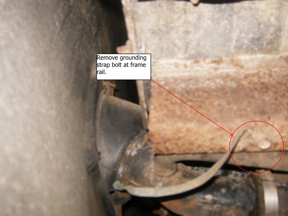

Easy one first. No the broken ground strap has nothing to do with your gas gauge. It is only there to dissipate any static charge that might build up while fueling. Prevents explosions.

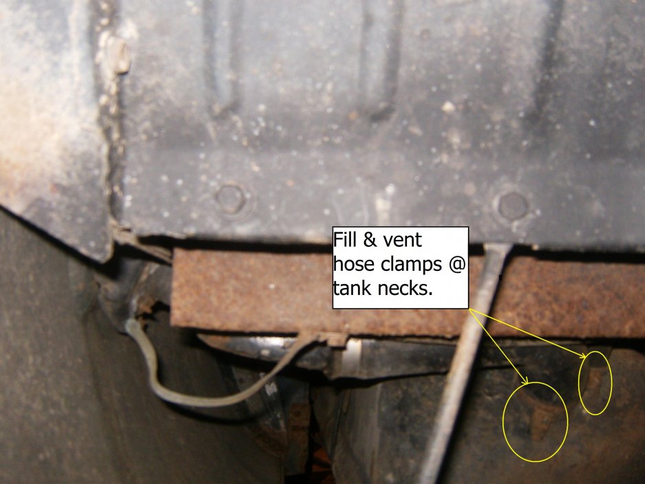

yes it is leaking where the neck meets the tank. It looks like it only has one house clamp on it now. I'm going to stop by tonight and get 2 new clamps and a ground strap since the one on it was broke. I have been fixing other issues and haven't had time to attend this one. But since I want to start driving it, I'm making time.

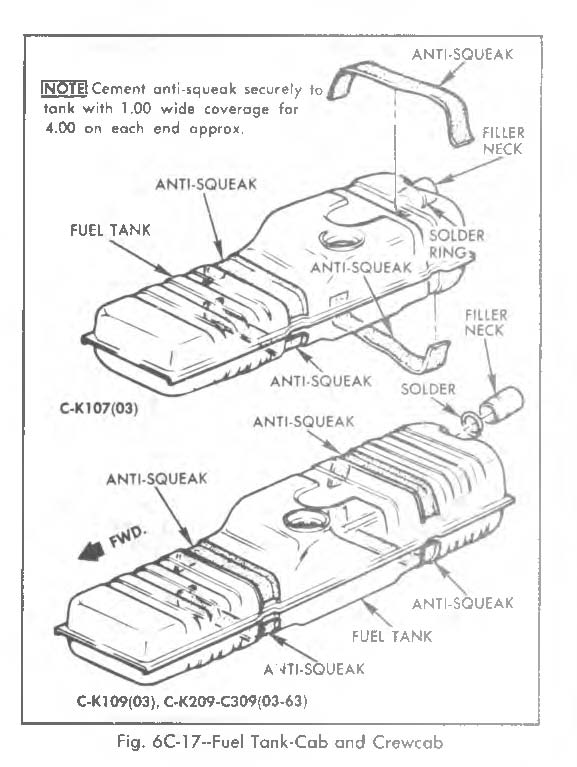

Did you read my long, boring dissertation on the construction of the fuel tank?
Quick version: that filler neck is added on at the last minute, depending on what type of vehicle the tank is going in. It is a soldered joint. To make that repair would require the tank be dropped, flushed, soldered and refit.
