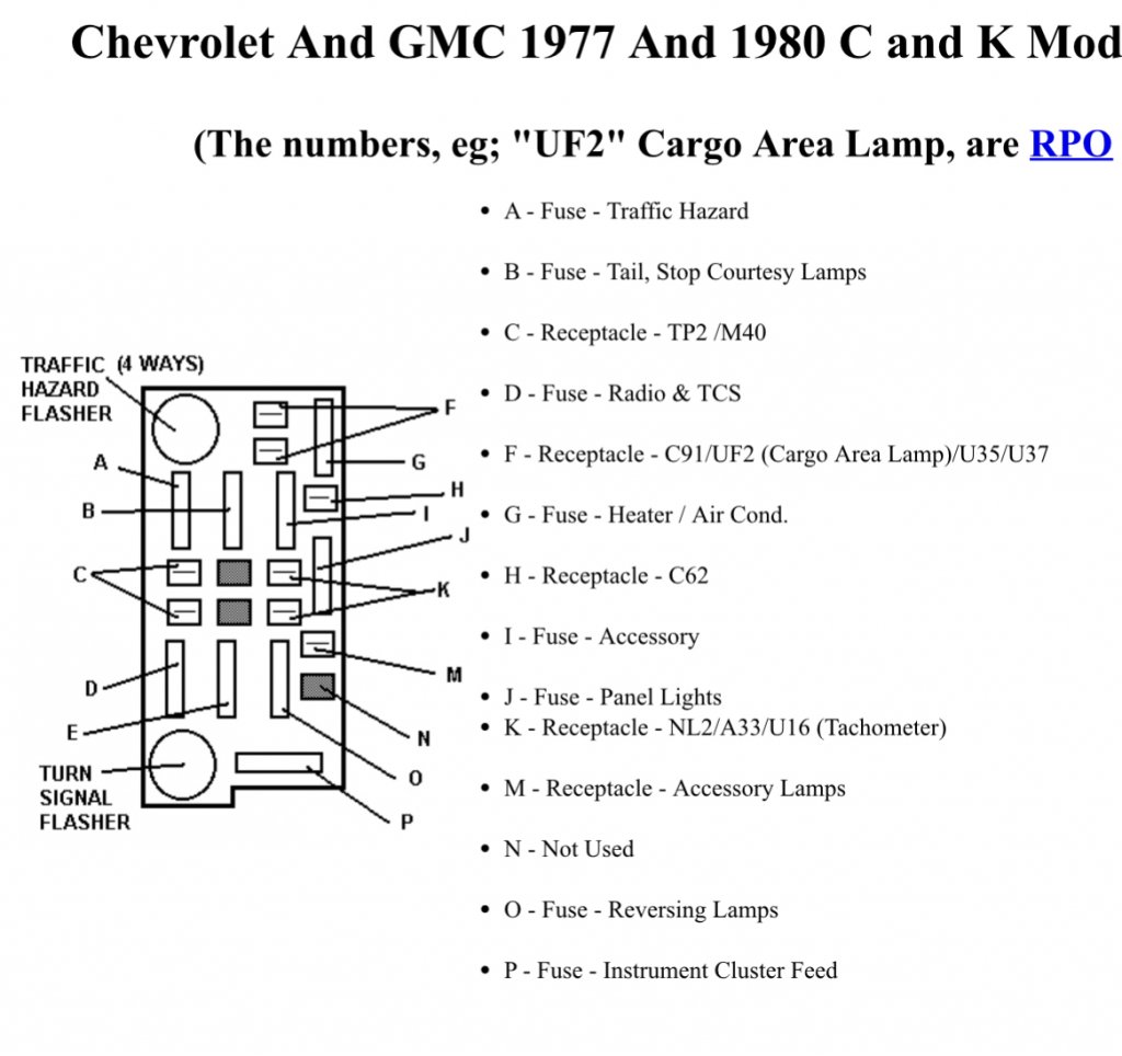

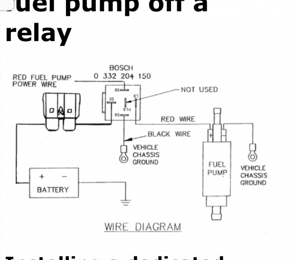

Guys on these two pics attached where it states #86 on the relay Red Fuel pump power wire can someone tell or show me where this wire goes to @ the fuse box ?

It goes to any ignition "on" fuse under dash. Get test light and probe, Either piggy back a fuse or find an unused ignition socket and buy the right plug.

Found an unused plug that said AC on it turned key on touched probe to it and said 12 volts put a spade on the 14 gauge wire and plugged it in ..Thanks!
