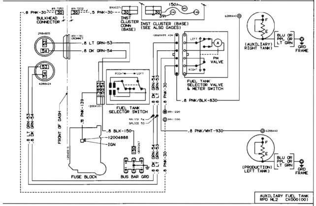

Solved
was given the attached wiring diagram from the 72-87 site and pinpointed the issue to the pigtail i wired in for the new tank selector valve. the light pink wire reporting to the guage was not connecting. cut out all butt connectors, reconnected all wires and soldered them. problem solved.

Awesome. Thanks for the update and fix. We've got that schematic on here somewhere but it never hurts to have it twice.
