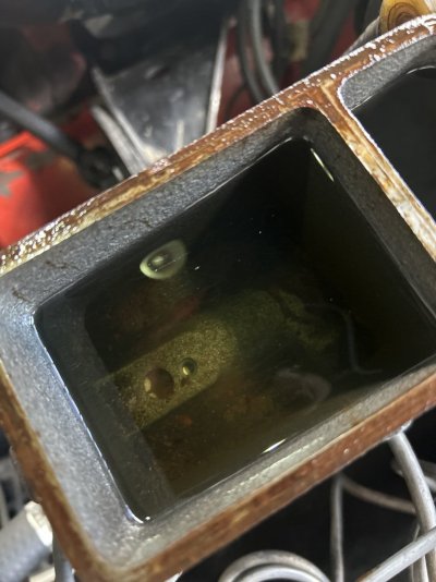

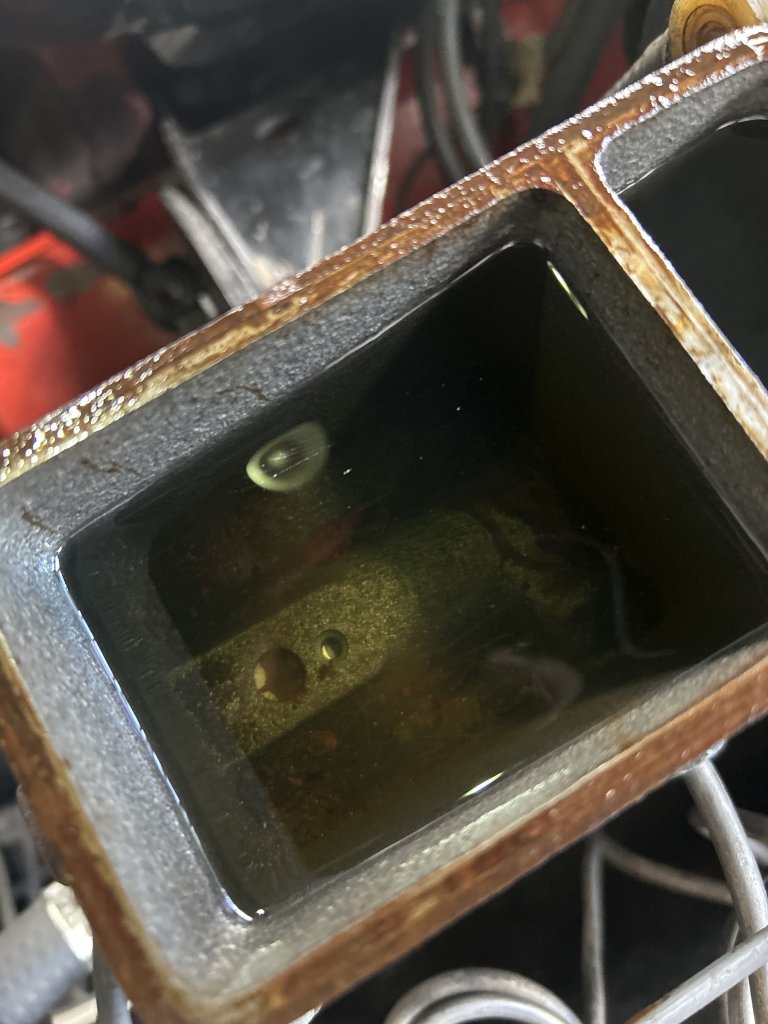

I was looking into the resovoir and it kinda looks like the hole is plugged?

Is the right hose new?
