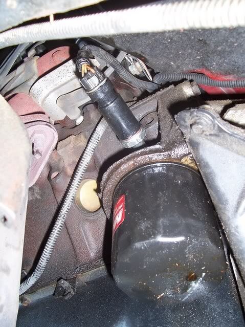

So I couldn't find the two wire sender you were talking about are you sure there is supposed to be one a the 90 v2500 small block?
Anyway I put a new pump in and filter and turned the key and now there is power to the pump I'm kinda thinking that the pump failed in a way that it couldn't complete its circuit and that's way it seemed to be no power at the pump I'm not sure. I'm pretty good with cars and trucks and it's mind boggling to me

I'm absolutely sure it's supposed to be there, but I wouldn't be surprised if it wasn't. Anything with some sort of factory in-tank electric fuel tank is supposed to. Here's a stock photo of one. It's threaded on one end, and it's a black tube looking thing with a plug on the other end.
