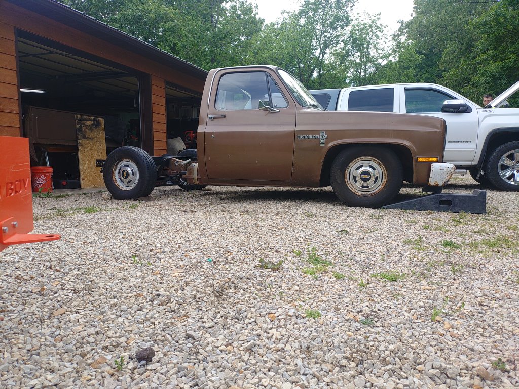

Had to trim about 4 inches off the front of the overload leaf. This truck was ordered as a 250 with MM7/MY6 4 speed and 770# rear light duty leaf springs.

Mine says 919# capacity on the camper label. 3+1 1.5” thick pack, factory 10 bolt axle, even with load assist shocks it dropped a good 7-8 inches with the flip kit and shock relocators. Spring and shackle bushings replaced with Energy Suspension red bushings, lots of their proprietery grease. I do need to remove probably 4-500 pounds of parts/tools from the bed though. Going to run 2.5” spindles, trimmed coils, swap the 4.3 for a 350.
Have a set of Z71 rear springs, pondering adding a leaf or two versus staying factory springs and track bars with the flip. If it hopped with a worn out 4.3, it’s going to have bigger control issues with a known 335 rwhp sbc…
