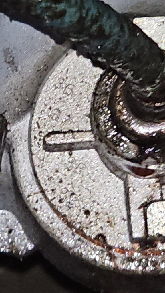

1. I'll attach pictures at the bottom.
2. I don't have an owners manual so I'm not sure how to get the axle ratio. i think thats what my biggest issue is.
3.the speedometer does not work currently but I believe that its because the owners put a new rear end on it and put the new transmission in it. I took the speedo cable off the speedometer itself and twisted the little ring counter clockwise and it does work if i do it manually like that.

As far as the speedo not working - you can pull that little housing and slip the gear out. You would be able to buy that same gear, like if it's green you can buy a replacement green gear.
I would make sure the square drive in the gear is not wallowed out and that it is able to drive the square portion of the cable. I would also rotate the trans and make sure the internal gear is driving the speedo gear.
