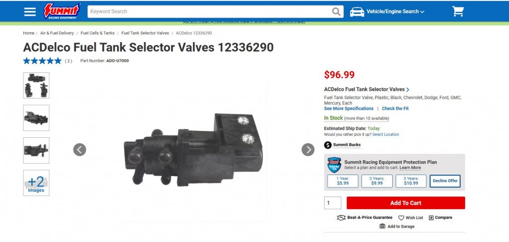

Dad's ole C20 Crew has a selector valve with one wire like the one in the pic. It appears that your truck has two installed for some odd reason.
Yeah, it looks like the truck had a 6-port valve and they couldn't find one, so they used a pair of 3-port valves. I don't see why that wouldn't work.
However, I do see a glass fuel filter that absolutely has to go. If it's not leaking currently, it will be.

Assuming you still want dual tanks - The six port solenoids with only a single power terminal have been unavailable for several years. If you can’t find a NOS solenoid, then the best choice is to switch to the newer version with a six wire connector. There are articles on the net that explain how to convert.

How hard is it to switch the wiring up to work with the newer 6-port? Can't be that complicated. I'm running dual tanks with in-tank pumps controlled by EFI and throwing together a schematic was pretty easy.
