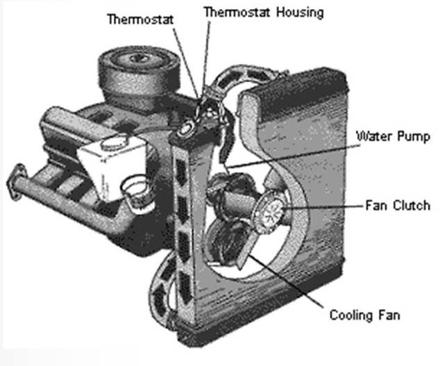

Without a clutch it may take a little longer to warm up on cooler days.
Really they are meant to 'disconnect' the fan from the engine at higher speeds (engine temps) to free up some power and help the engine be more efficient.
Good explainantions here:
