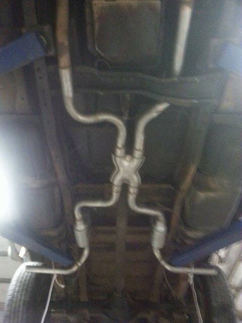

Exhaust is done!
Haven't seen it yet but have a pic of it and a couple vids, may need some tweaking/redoing eventually, ran into an issue with the crossmember, apparently these trucks were designed for one pipe over and one pipe under the crossmember, so for now this will be how it is, but I found an aftermarket crossmember that I may need to get to fix the passenger side pipes. I'm not sure if I'm totally happy with the end result on looks but maybe the sound will remedy that. I'm not crazy about how he routed the passenger side, but due to the xmember I'll have to live with this for a little while. I visioned a bit more symmetrical pipes, but notice there isn't a ton of room to work with. Hope the xpipe was worth the cash, won't really know how she runs until tomorrow night.

You will notice the difference with either an X-pipe or an H-pipe. V8s do not fire R-L-R-L, they fire L-R-R-L-R-L-L-R (1-8-4-3-6-5-7-2). The second beat of the double pulse every revolution of the crank meets resistance from the pressure of the prior pulse still in the exhaust. Relieving this is the primary purpose of the X-pipe or H-pipe, to get better exhaust scavenging from cylinders 4 and 7.

This is the first time I've ever used an xpipe, although I have to have the mufflers replaced, the truck sounds good and seems to run better, still have some carb adjustments to do but overall it sounds much healthier, just not the tone I wanted, but that's because of the super10 mufflers he installed instead of using the 40s style like I wanted, the bending and pipe work could of been better but for now I'll make it work.
