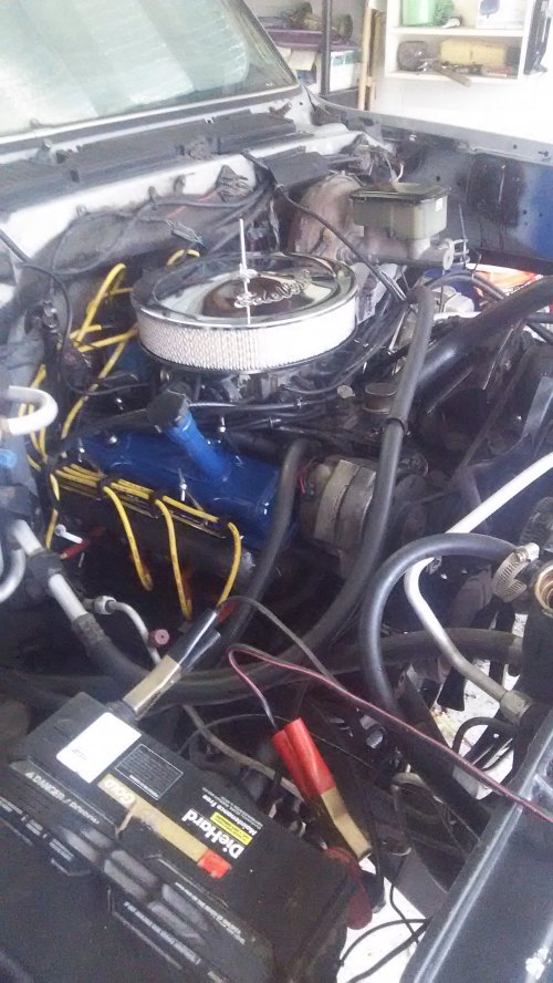

Need help I have a 1984 chevy Scottsdale 305 65,000 original miles just took off the factory manifolds the air tubs and the smog and belt did new spark plugs and wires filter oil everything and I can just turn the key and turn then it will finally run I slam my foot on the gas and it will stay running but really low like the idea really really low the motor shakes and wobles it was running perfect before I did all this I have the spark plugs gaped proper the wires are right wth is going on is my engine done for or s it something stupid can it be that I took off the emissions

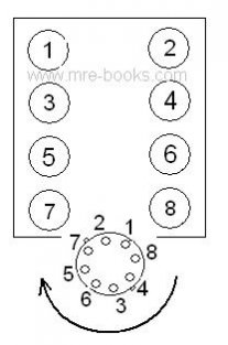

Are you 100% certain the wires are correct? Sounds like they may not be. Odd #'s on driver side, even #'s on passenger side. Firing order is 1-8-4-3-6-5-7-2.
Plugs on dizzy are in pairs. #1 should be the left plug on front pair (away from firewall) if dizzy is setup right. Go clockwise from their following the firing order.

Top of pic is front of motor
