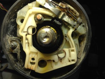

I have finally got my instrument clusters gauges working properly. But before I put it all back together, my horn and emergency flashers are not working. the blinkers are working correctly. Does anyone have any pointers on where to start looking to correct these two? Do I have to disassemble the steering column?

The fuse is good. I have taken apart the steering wheel. I can get the switch on the side for the flashers to work on the right side blinking and only when the key is on. I can toggle the switch back and forth and get the same results. Do I need to replace this piece? If so, what it is it?

That is the portion of the directional/hazard switch that houses the contacts required to operate the various indicating lights. Yours appears to be cracked straight through the its casing. I am definitely not an expert on this particular switch. But if I had to guess, I would say say that; yes - due to the cracked casing - the directional switch should be replaced.
The R&R procedure for the directional switch is involved - and it terrifies many people.
But its not too bad - if you read and understand this tutorial:
http://www.truckforum.org/threads/77-gmc-steering-column-help.35364/
When you are done, you will know more than nearly anyone about disassembling a C/K upper column, replacing the various components and the reassembling it. Its supposed to be just about replacing the ignition switch rack that is attached to the lock cylinder, but to get to it requires a nearly complete tear-down. It is worth the read.
