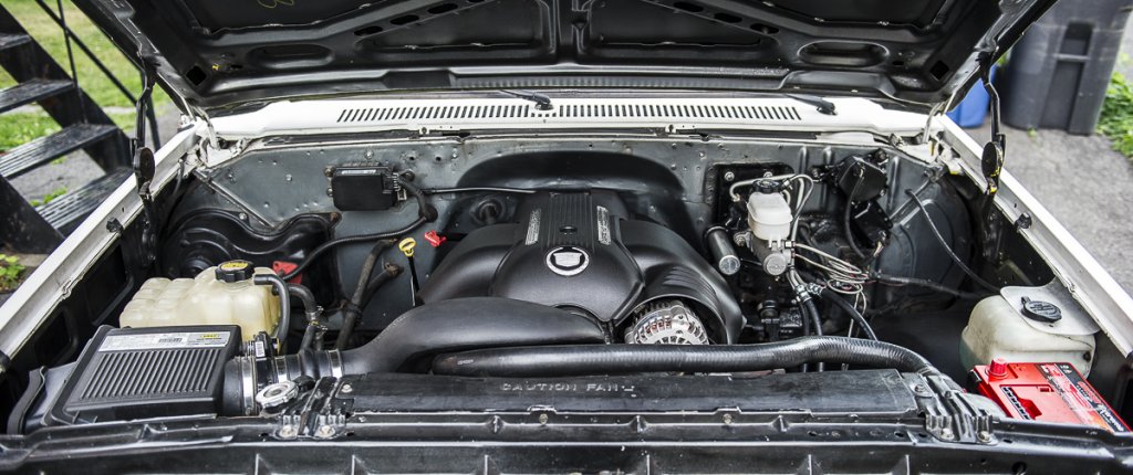

LQ4 6.0L
love my 20mpg $500 6l LS so easy to swap and so much power and reliablitie! :)
