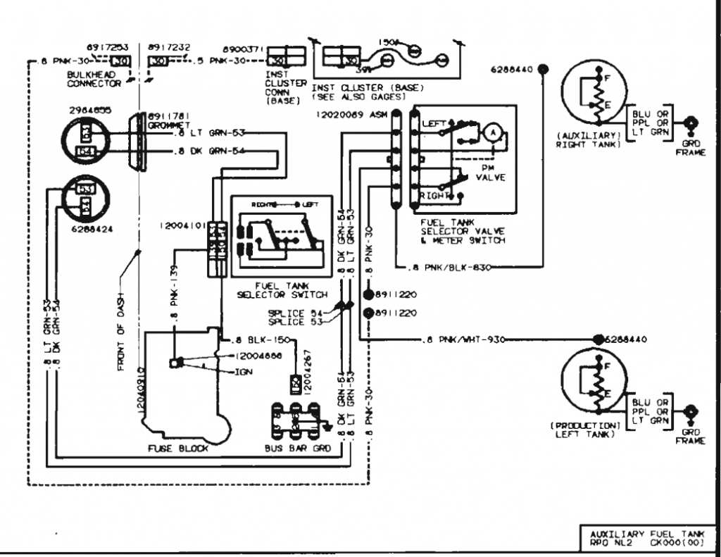

I would think that the wiring going to the new switch is backwards, (reversed), or the wiring going to the valve is wrong. It could be someone replaced the parts in the past and got it wrong. I would switch the wiring at the switch to see if it corrects the problem. The good thing is that the switch works. You could just change the label on the switch. :33:

Wiring diagram

It reads and pulls fuel from the appropriate tank. Just switched to R it switches to L tank and visa versa. Thanks for all your replies. I don't drink.

just interchange the light green with the dark green harnesses from the tank switch and that is it to avoid cuts in the middle of the harness
