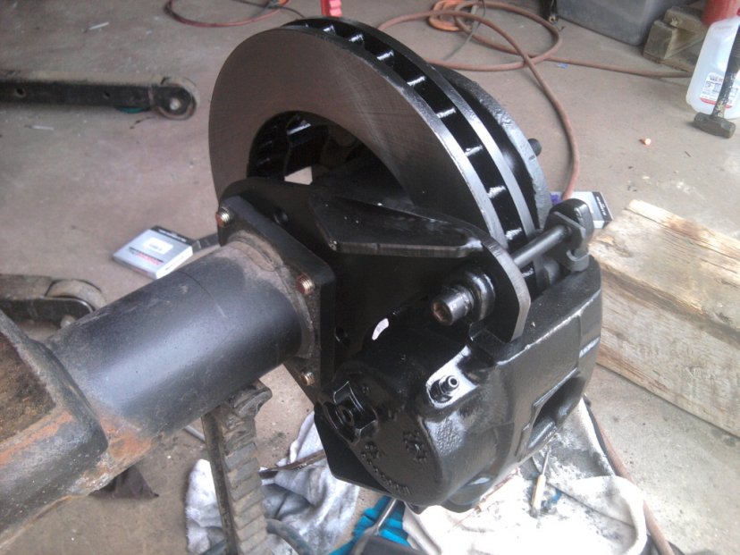

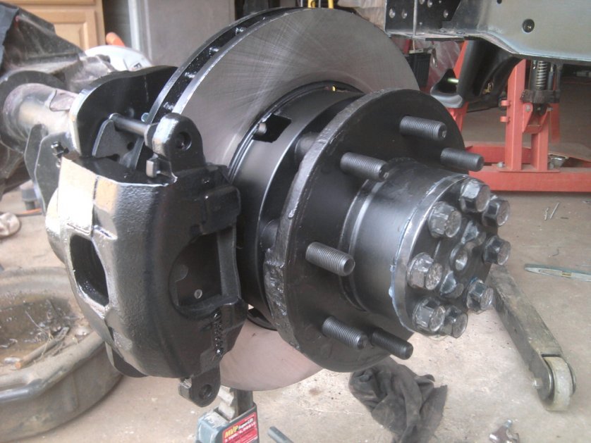

im doing one right now as soon as my parts from diy4x.com is where i got my brackets from i was able to get other parts from junkyards or rock auto

kleedus
Jan 25, 2012
1,726
164
wyo
Ray
1960 threw 91
c10 to k30
350 threw 454
diy4x brakets
