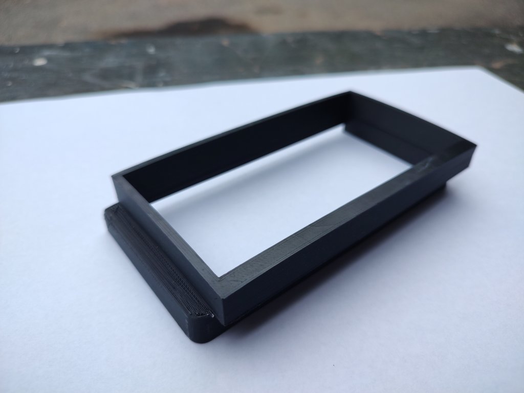

I'm sure tape, foam, or similar fixes work fine. Mine had a gap and was offset, so I made a simple sleeve with my 3d printer. It also solved the problem of giving a place for the screw to be useful. The Forum won't let me attach the STL file, if you can use it let me know. I used ASA filament, I don't think PLA would last long with the temps.
