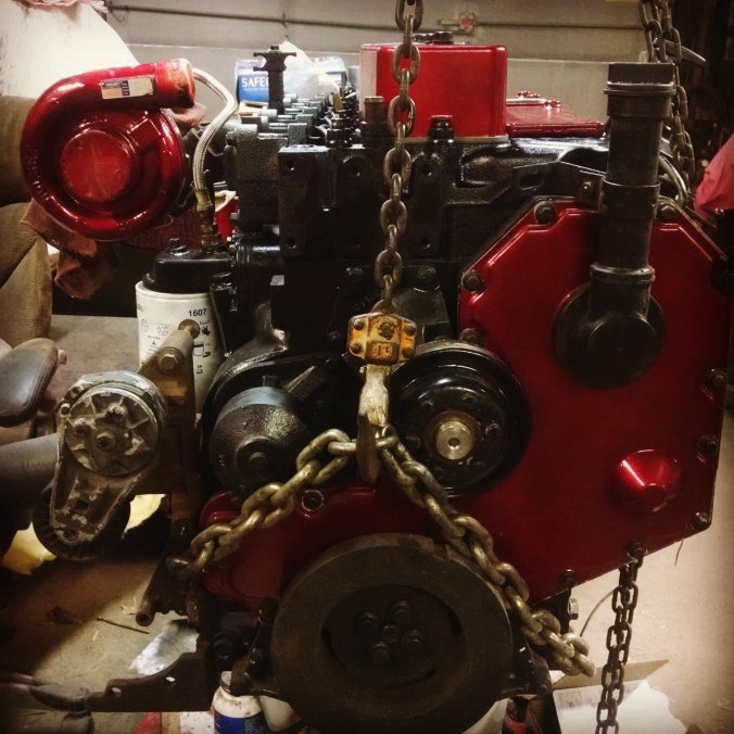

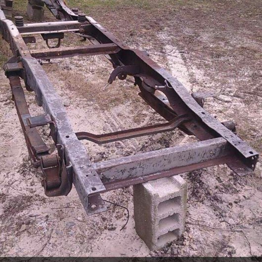

Okay been working on a Cummins swap for a while know also 4wd conversion so far I have a 91 Cummins with getrag and auto np205 t case dana 60 and 70 dodge axles for truck I have an 87 2500 2wd bought a 78 k30 frame with springs getting ready to put the axles under the frame I know the perches are narrower then the gm ones questions I have are:
Do I have to modify the dodge perches on the axles and any other differences?
Trans cross members what have other members done?
And fuel tanks can I use a gas tank and make my own pick up tubes and sending unit?
Here are some pics of the build

wholey **** thats gorgeous....
