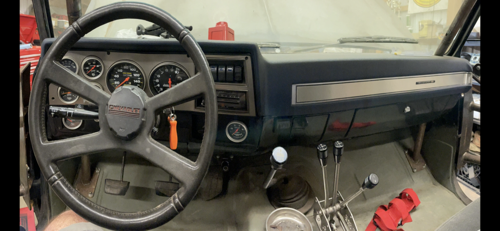

I put a Coverlay Manufacturing dash cover on my dash and I’m happy with it. It looks good and literally saved me hundreds of dollars. It’s not perfect but it’s pretty close.
My Blazer is parked inside but I’ve read that constant exposure to heat / sun can make them ripple or bow but I’m thinking that could also be installation.
You will need some original dash pad to glue it to, it’s glue all around the perimeter with RTV so I’m not sure how well that would adhere to bare foam padding.

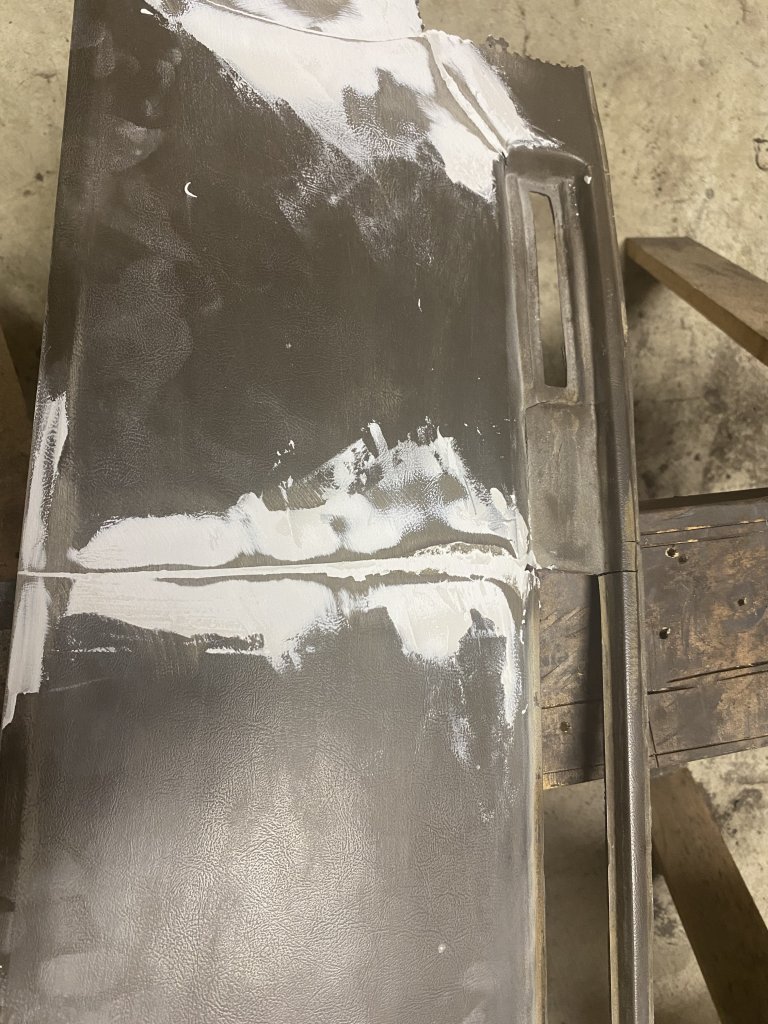

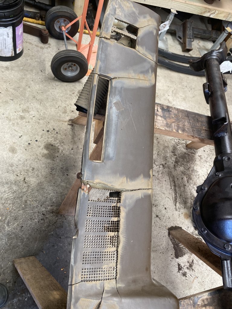

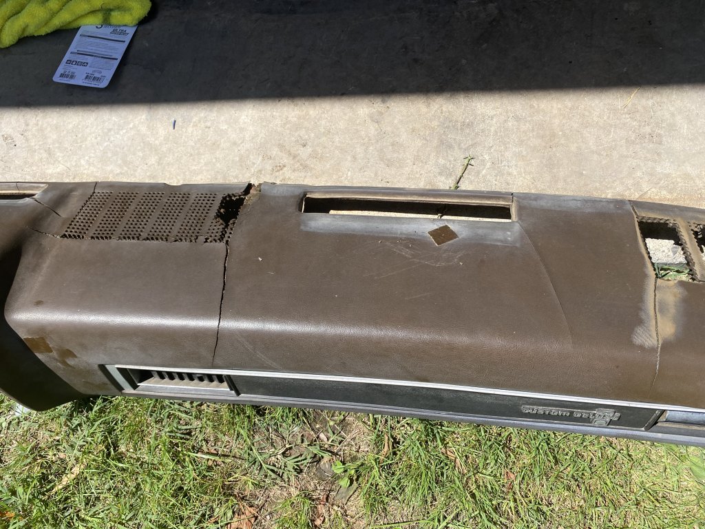

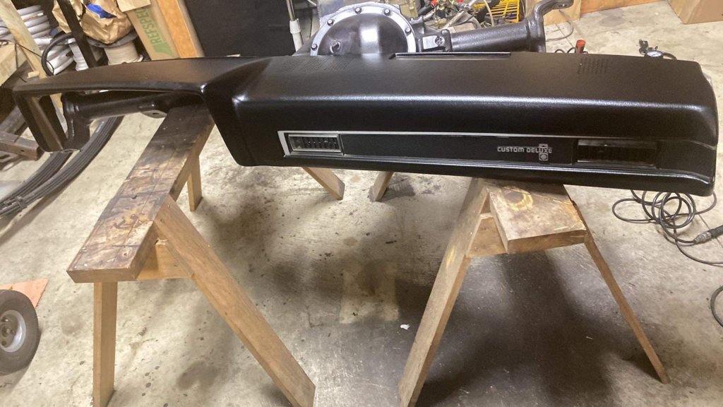

Here’s my coverlay experience. Sanded down the high spots. Filled the gaps with a dash filler, slapped on coverlay and re installed. Very happy with result.
