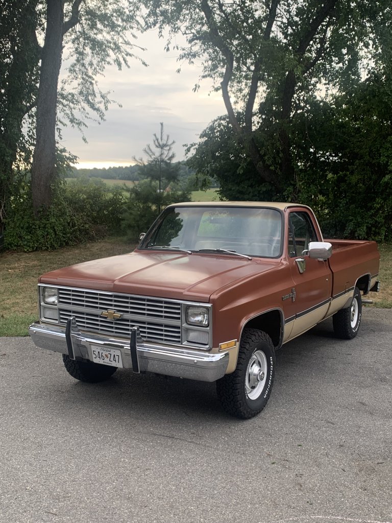

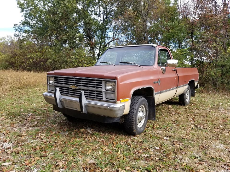

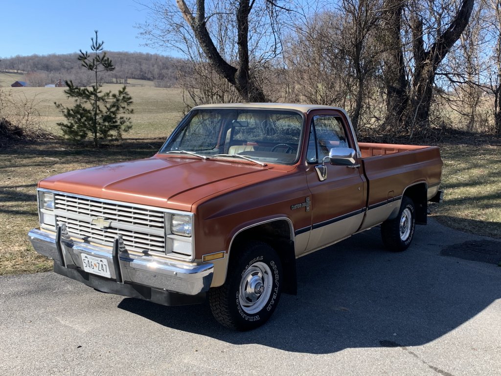

First post Newby, but I would really recommend reading this... it talks about single stage paint and how to restore/preserve it in a non-aggressive way. Compounds can be very aggressive if you aren't careful.
I followed it. Here are my before and after... the last one is 6 months later after just normal washing.

Good advice.It’s amazing what a little time and elbow grease can do. Welcome to the forum.
