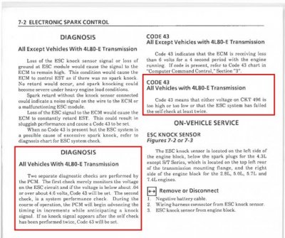

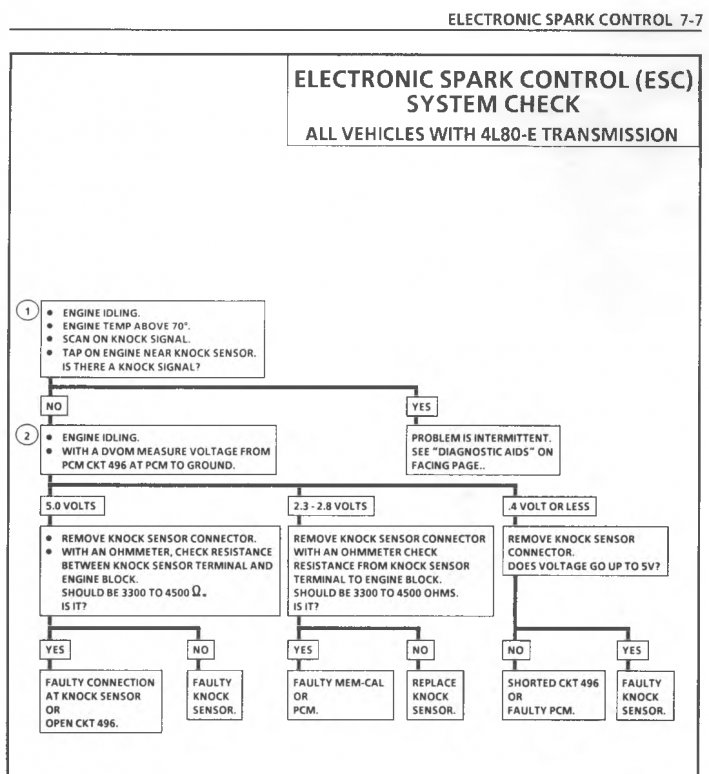

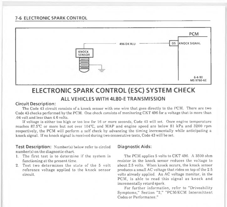

Seems they're more concerned about voltage out of the ECM at D5. But you have changed the ECM, so that should eliminate voltage out.
Circuit 496 (the DK BLU lead to the sensor from D5) has been checked for continuity and ground faults. That should eliminate the wiring.
Only thing left is the sensor. But, you have changed that too.
Check for resistance across the sensor (from the terminal to the block). They want between 3300 and 4500 ohms. If it is high, maybe check the threads in the block. No teflon tape on the sensor threads - right?
If it's low, maybe you got a bad one out of the box?
Those were just a few thoughts I had, someone who knows more about this circuit will probably be along soon to help.
Some info on code 43 (earlier year but still valid):
